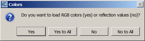

One question though:
is it normal that when opening FARO fls file CC displays the following message?
I would expect CC loads both RGB and the scalar (reflection) as happens when PTS file is loaded...
Maybe some additonal DLLs should also be registered in the similar way?
Re: Cannot load FARO fls files
Posted: Sat Apr 04, 2015 2:49 pm
Indeed, the SDK we are using impose to chose whether to load colors or reflection values (we can't get both... or we should read the file twice).
In the following version we may use another SDK though.
