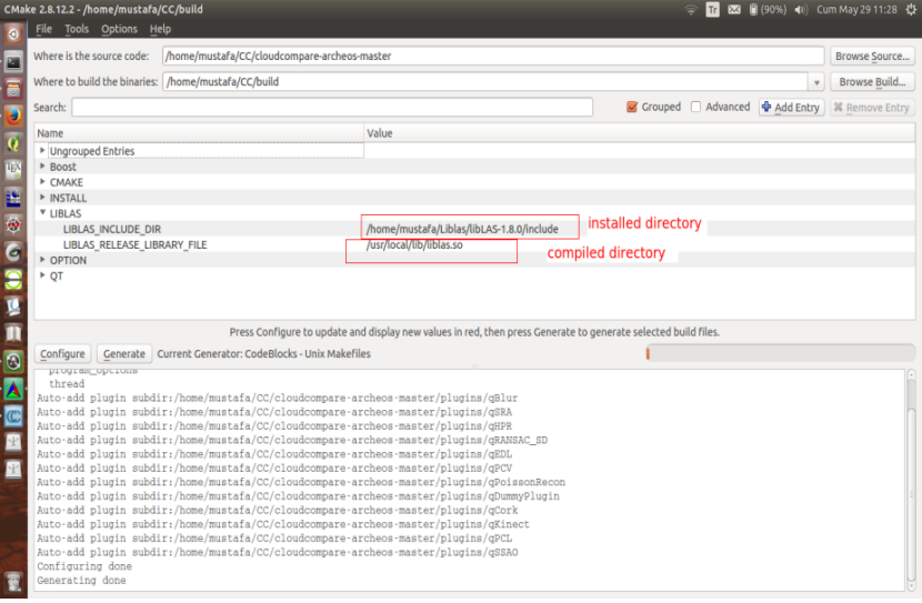

I have a problem with Las file importing.
I choosed the option use liblas in CMAKE. An error occured, "error in configuration process, project files maybe invalid"
I read the wiki for liblas, but I am confused. I am using CC 2.6.1 beta on Ubuntu 14.04.
Do I need to install Liblas? from liblas.org ? or CC has the library?

You have to compile liblas on your side then tell CMake where the resulting library file and the include directory are.

I have compiled and installed liblas. But I got an error
WARNING: Target "QCC_IO_LIB" requests linking to directory "/usr/local/lib/". Targets may link only to libraries. CMake is dropping the item.
WARNING: Target "CloudCompare" requests linking to directory "/usr/local/lib/". Targets may link only to libraries. CMake is dropping the item.
WARNING: Target "ccViewer" requests linking to directory "/usr/local/lib/". Targets may link only to libraries. CMake is dropping the item.
I think I am showing the folders wrong to CMAKE. Which folders are need to enter there? compiled (builded) files of liblas? or in \usr\local\ lib ?
I am confused.
Thank you.
Re: Opening las/laz files
Posted: Fri May 29, 2015 6:43 am
The LIBLAS_RELEASE_LIBRARY_FILE must point to the actual library file (.a or .so on Linux). When you 'install' liblas, look where it is copied (I guess it is indeed in /usr/local/lib but you must add the right library file at the end of the path.

Dear Daniel,
Thank you so much. Now, I can import Las files.
