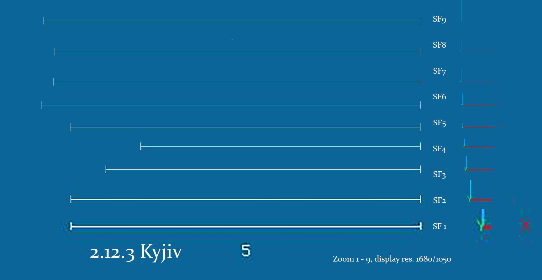

it seems, this problem hasn´t been fixed, or something has changed - it seems, zoom 1, 2 and 5 works fine, others don´t (I tested it until zoom 9). Please, it is possible to fix somehow? Thank You and thank You for the CloudCompare!

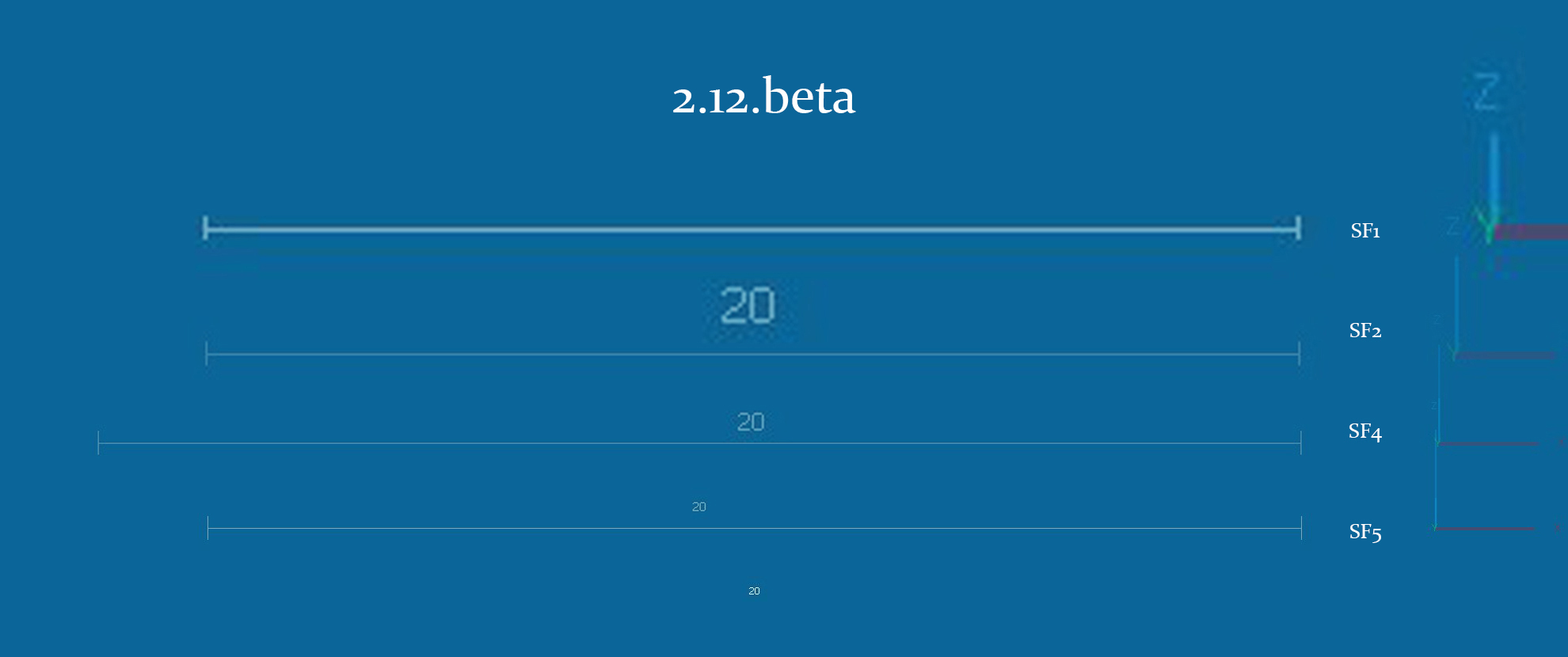

I have used v. 2.12.3 Kyjiv (zoom 1-9), now i tested 2.12 beta (zoom 1 and 4), the scales are not right. I have made a graphic comparation, but I don´t know how to post it here :)

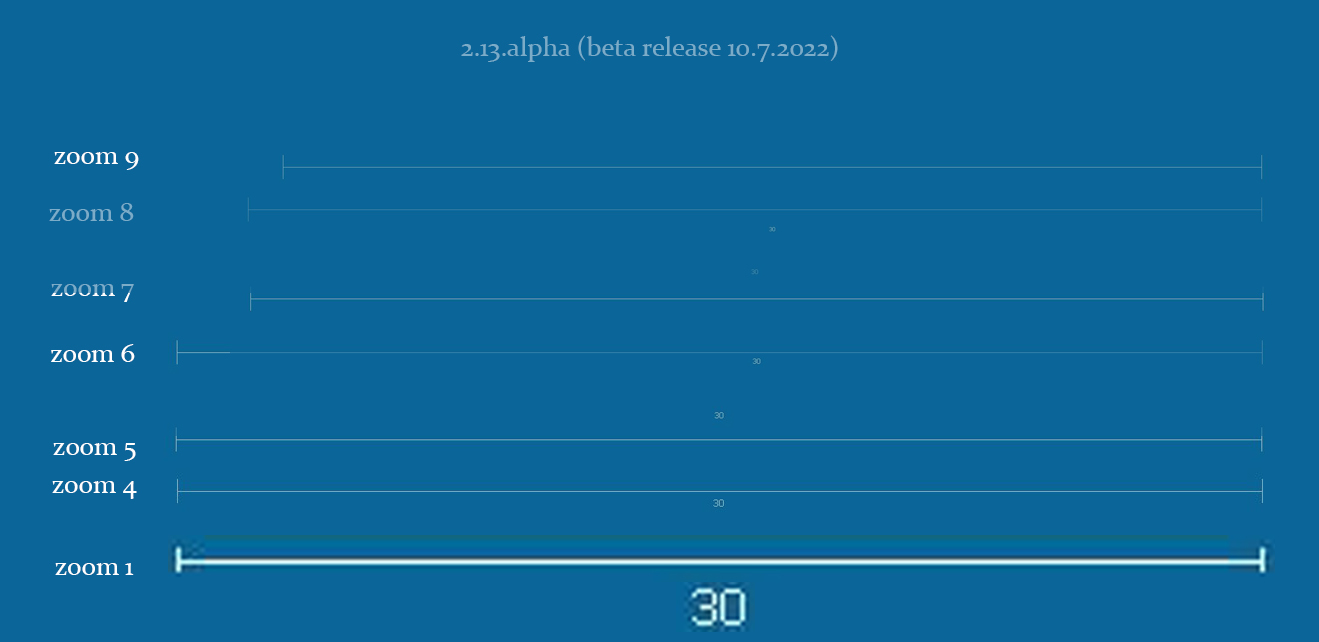

Sorry, I haven´t noticed, here are the pictures:
Even now, v.2.13.alpha (Latest beta release: 2.13.alpha (7/10/2022)) there is still scale distortion, begins with zoom 7. Zoom 1 to 6 is correct. To me, scale 6 is enough, but I don´t know about others, maybe just add warnings since zoom 7?

Re: Scaling problem
Hum, that doesn't really make sense, but thanks for the feedback! I'll need to dig in deeper in the code to understand what happens...
