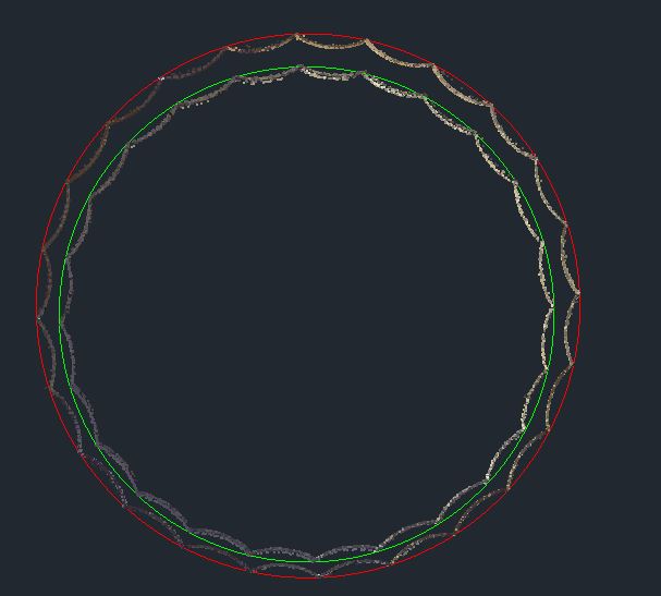

I want to unwrape a pillar which has cone shape. How can I do it. For cylinder I knoww CC works well.
Lower radius=1.8506 m (red in pic)
Upper radius=1.6849 m (green in pic)
Please see attached figure.

Re: Unwraping cone shape structure
Well you "just" have to do some math in order to deduce the cone apex position and angle. I guess Thales is you friend here (you just need the height between the red and green circles ;).
Then the "Unroll" tool has a "Cone" mode.
EDIT: anyway, the green and red circles don't look very well "centered". Not sure what you'll get. Maybe unrolling this column as a "cylinder" would not be so bad.

The coordinates of my pillar
Bottom circle : xyz: 22.2154,59.3347, 0
Top circle : xyz: 22.2170,59.3813,24
Yes, The pillar is not straight.EDIT: anyway, the green and red circles don't look very well "centered"
It would be too much approximation. Don't you think so. I need to do for mm accuracy.Maybe unrolling this column as a "cylinder" would not be so bad.
Please help me to find solution.

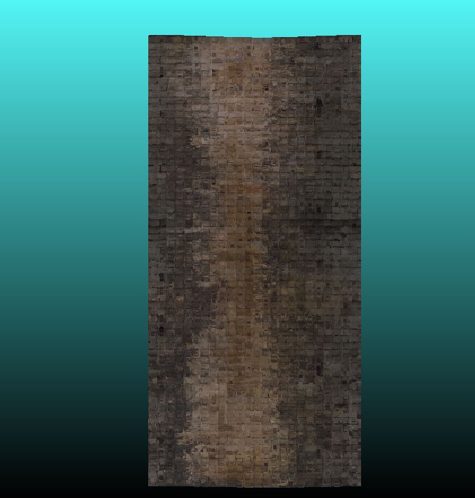

Dear,
I'm trying to use
unroll->cone but still not working.
my parameters are:
center:
Bottom circle : xyz: 0,0,0
Top circle : xyz: 0,0,24.6
radius:
Bottom circle : x,y,z: 1.84 m
Top circle : x,y,z: 1.68 m
Cone apex: 0,0,275 (I just calculated)
angle:0.38
projection radius=1.84 ( WHAT should I give)
I 'm getting unroll with lower and upper edge of same length.
If required, I can send you pointcoud also.
I'm trying to use
my parameters are:
center:
radius:
angle:0.38
Oh maybe that was not clear but this is exactly what the 'unroll' function does (even for a cone). It unwrap the surface as a 'rectangle' .
This is not a 'conical' projection.
Should it not be like this
- Unroll a cylinder.JPG (190.75 KiB) Viewed 17423 times
Yes it could be. But this is not what this tool is doing right now.
Maybe we could add this as an option: can you send me your cloud and the parameters so that I can update the code? (cloudcompare [at] danielgm.net)

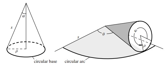

You can look at this paper:
http://www.mamikon.com/USArticles/Rolli ... inders.pdf (page 402)
1) You have first to project each point on the theoretical cone (either orthogonal to the surface or radially)
2) Then you can apply the 'unroll' equation. Let A be the cone apex, alpha the opening angle and P(x,y,z) be the projected point. lets assume also that the cone axis is Z (I'll use the figure notations):
Eventually you'll have to apply a kind of Lambert conical projection (see http://en.wikipedia.org/wiki/Lambert_co ... projection). But is should be simpler (I think theta is the longitude and the latitude is constant in your case. And you already know rho also. I don't have the time to look at the details right now ;)
s = norm(P-A)
rho = sqrt(x^2 + y^2)
phi = atan2(y,x)
theta = phi * sin(alpha)
