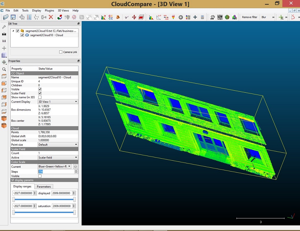

Greetings,
I have a data set (please see attached print screen) which I wish to modify the coordinate so that the bounding box plane is parallel to the facade's plane. I mean how I can modify the coordinates of this particular point cloud based on main coordinate system of software? Can you please advise?

there's multiple solutions (select the cloud first):
  • use the manual transformation tool ('Edit > Translate/rotate') but it will be approximate
  • fit a plane on the cloud (with 'Tools > Fit > Plane') then right click on the plane entity in the DB tree (should be a child of the cloud) and click on 'Align camera'. You'll see a matrix output in the Console (F8). Copy this matrix (CTRL+C) then select the cloud, open the 'Edit > Apply transformation' tool and paste the matrix there. Apply this transformation and your cloud should be aligned with the (XY) plane
  • with the latest beta release (v2.6.1.beta online) you can automate this with the new 'Tools > Level' tool that let you pick 3 points so as to define an (horizontal) plane that will be used to re-orientate the plane automatically (i.e. the plane is made parallel to the (XY) plane once again). You can afterwards apply some simple transformations (with 'Edit > Apply transformation') so as to get the right orientation (i.e. the plane parallel to the XZ or YZ planes)
