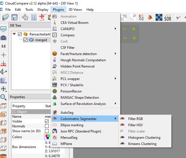

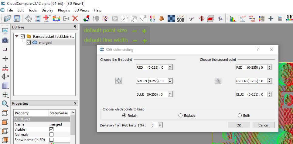

Re: select / delete points by color
Posted: Tue Jun 08, 2021 5:02 pm
by WargodHernandez
We have the colorimetric segmenter for this now
