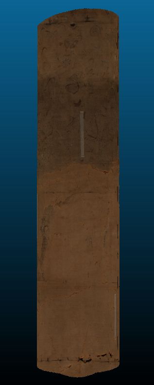

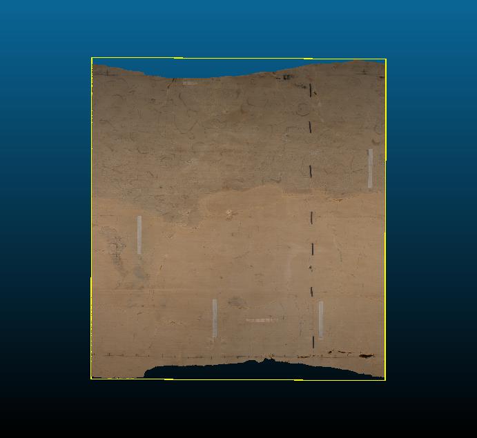

so maybe images are clearer to explain what I obtain :
original mesh with texture :

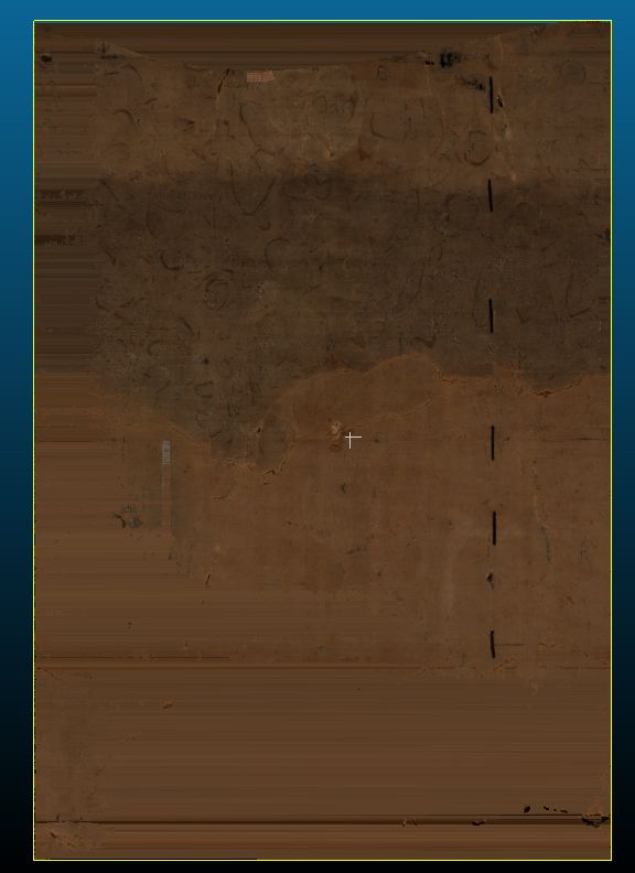

unrolling previous data with cylinder gives :
observe the strange horizontal lines in the left and bottom part of the image
I precise that I tried with different radius for cylinder thinking it was a probleme of intersection the mesh with the cylinder, but it doesn't help

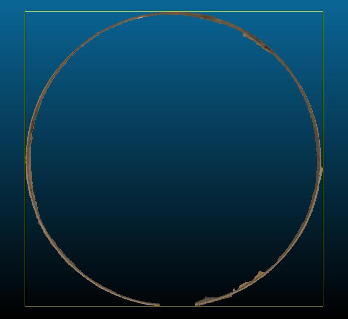

unrolling only the point cloud and remeshing gives :
The geometry is OK, but the image quality is poorer

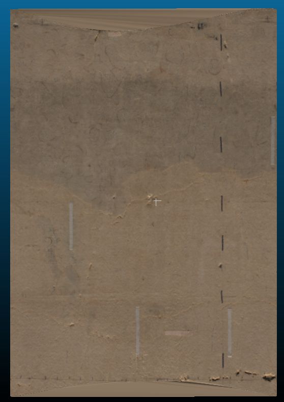

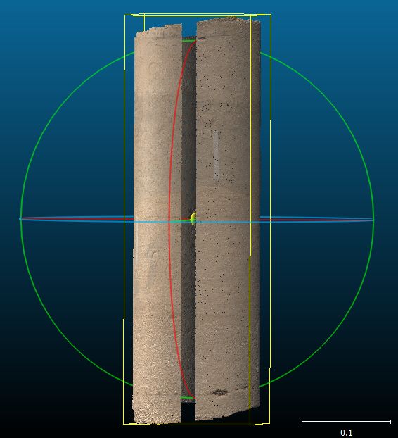

From your posts I got ideas and I found a trick that does the job. You need to cut a vertical band of the core (cylinder) in order to unclose the mesh. The location of the cut is important, so make different tries to find the good one.
For our needs this will be good enough even if it's a little tricky.
Here are screenshots of the cutted core and the unrolled result.
