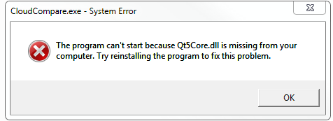

The CloudCompare project built successfuly in VS 2012 and created the correct files in the install directory. I've changed the debugging command of the Install project to point to the cloudcompare executable, and rebuilt. But when I tried to run the application I got the message:
cloudcompare error.png (11.46 KiB) Viewed 24260 times

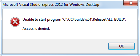

Also, if I hit the build and run command from Visual studio, I get this message:
cloudcompare error 2.png (19.55 KiB) Viewed 24260 times
Which is strange because I definitely have administrator access.

For the second issue, it's simple: you have to 'set as startup project' the CloudCompare project instead of the ALL_BUILD one. Just right click on the CloudCompare project to choose the corresponding option.

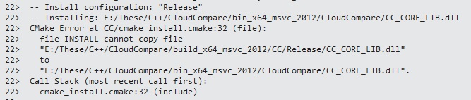

For the first issue: do you see the 'Qt5Core.dll' file next to CloudCompare.exe in the installation directory? If not, when you compile the INSTALL project, do you see any error at the end in the output console? (when CMake actually copies the files).

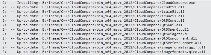

If everything works, you should see something like:
And if there's an error (or if Qt5Core.dll doesn't appear in CMake output) where does QT5_ROOT_PATH points to in your CMake configuration?

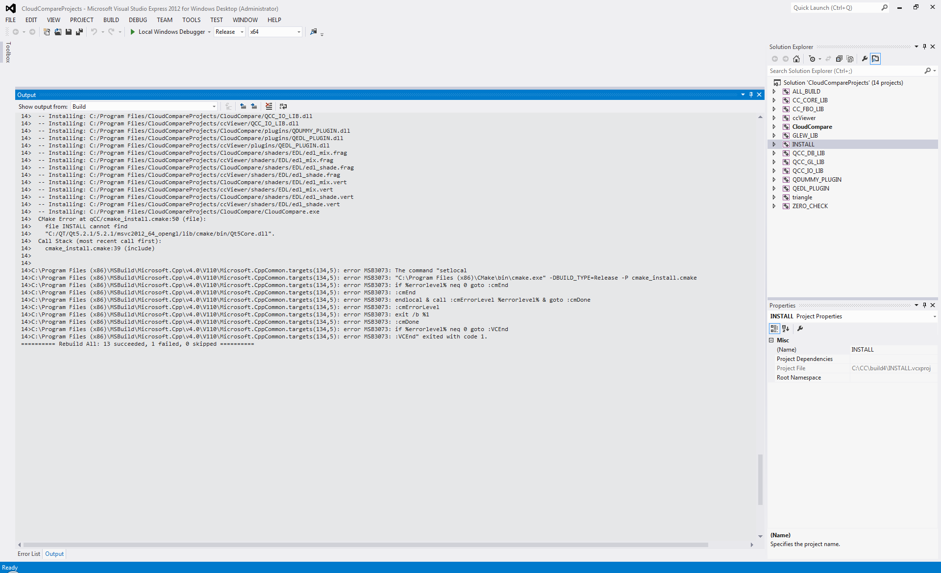

There's no Qt5Core.dll in the installation directory,
There are some errors in my console:
cloudcompare error 4.png (132.33 KiB) Viewed 24259 times

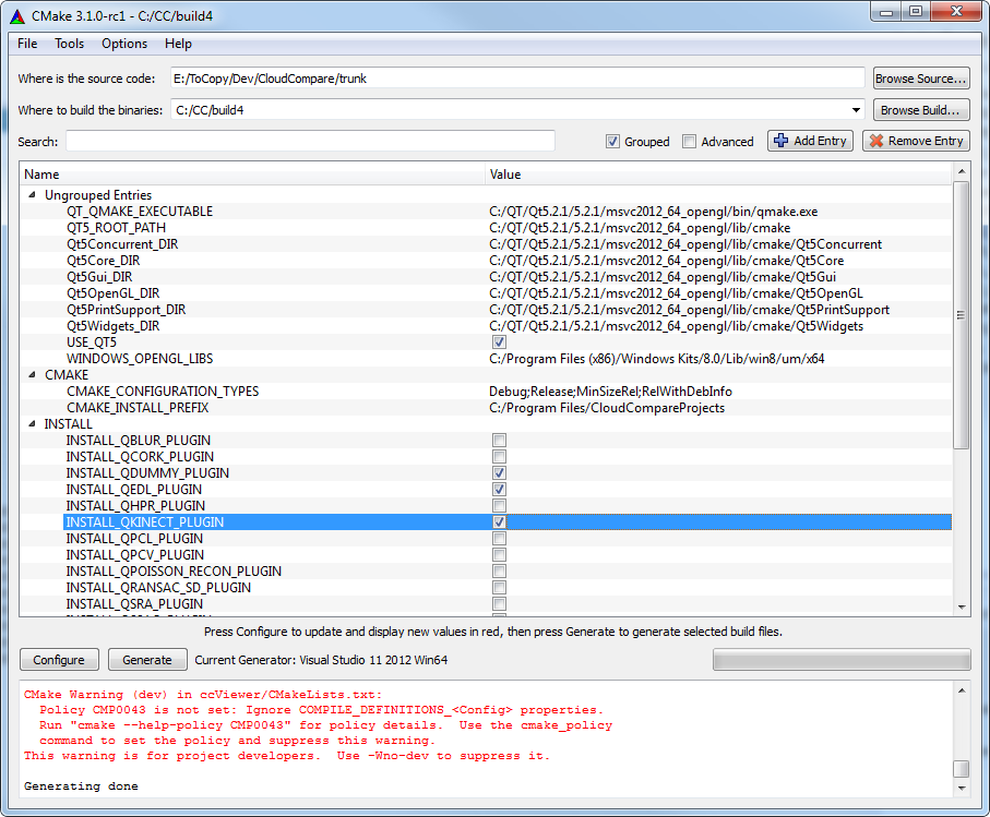

And here is my QT setup in cmake:

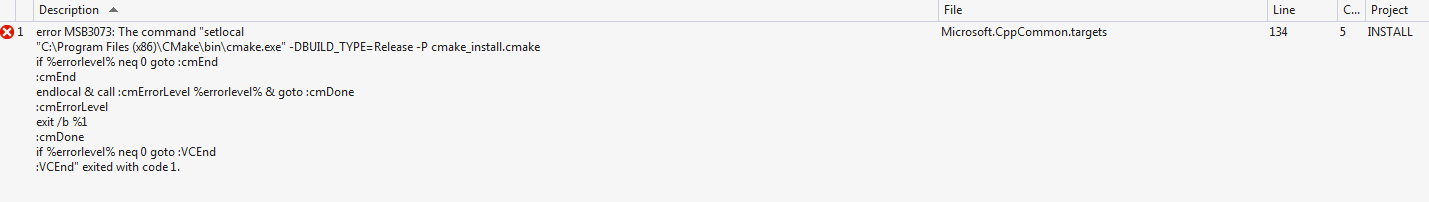

I'm also getting a build error message in Visual Studio:
cloudcompare error 5.png (13.49 KiB) Viewed 24259 times
Thanks for your help so far, and I apologize for all the questions! as you can tell, I'm a bit of a newbie at this!
Re: Trouble building CloudCompare
Posted: Wed Nov 05, 2014 9:51 pm
I think the only issue is that QT5_ROOT_PATH is wrongly set: it should be something like "C:/Qt/Qt5.2.1/5.2.1/msvc2012_64_opengl" (nothing more ;).
This way Cmake will found the Dlls, etc.
