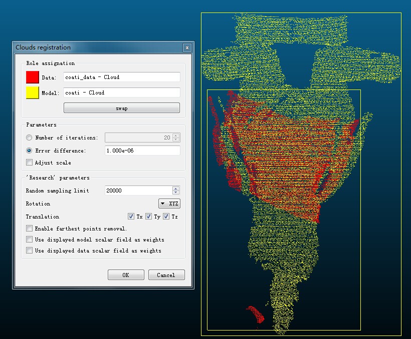

I want complete the function like the "swap" in "Cloud Registration",if I clicked the "swap" button,the color of the selected enties will change.

Then the best way it to create your own dialog for the plugin (by duplicating most of the content of an existing one if necessary). See how other plugins (such as qPoissonRecon, qRansacSD, etc.) do this.
You can also copy the more simple 'Choose entity role' dialog (ccOrderChoiceDlg).
