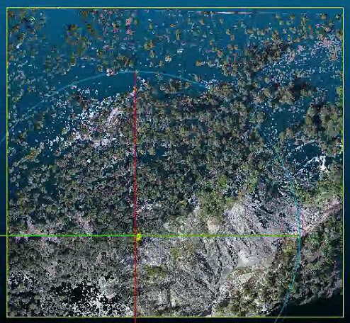

Basically I'm a geotechnical engineer and I'm interested in extracting bare-earth models for slope and other analysis. I've used qCANUPO to classify my point clouds, however, I couldn't figure out how to separate/delete vegetation from the ground (bare earth) points after classification.
I really want to see and export (as laz or laz, dwg) a colored (point cloud has sRGB properties) bare-earth model after classification. Or if there's is an option where I can check or un-check the vegetation after classification. Please see attached images for reference.
I'll really appreciate a quick response.

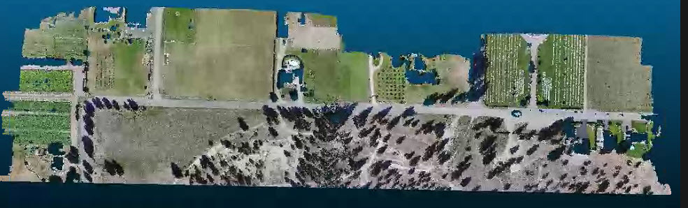

I've classified a very large photogrammetry based point cloud (approx. 280 Million points) using qCANUPO. I constructed my own classifier using trial and error in Train Classifier and I really take this opportunity to thank you guys for your work, especially because you've made it open source.
For flat to generally undulating areas, the results have been amazing I've extracted bare earth model, that is good enough for my project (Figure 1). Area looking black are actually tree shadows and not trees.

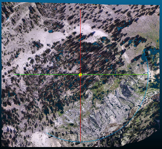

However, for relatively steep slopes with thick tree cover and/or surface erosion debris, there're certain points which were classified into vegetation but actually correspond to earth/ground, e.g. For one such area in the project site, post classification results are shown in Figure 3 (Bare Earth)
Figure 3.jpg (182.14 KiB) Viewed 566817 times

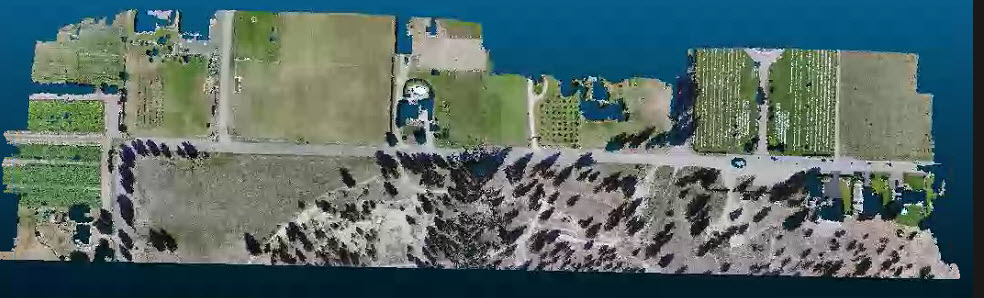

and Figure 4 (Vegetation).
Figure 4.jpg (125.43 KiB) Viewed 566817 times
In Figure 4 you can see that there points (white/brown) that should've been classified as bare-earth but weren't. Could you guys suggest what is the pblm here? The scale for my classifier varies from 0.10 to 25 with a step of 0.20. I've used upper limit to be 25 because there're certain houses on project site that are close to 25m in length.
