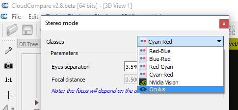

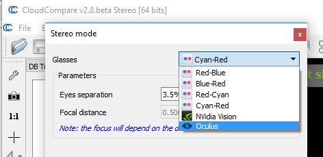

Non stereo version: [img]
[/img]
stereo version:[img]
[/img]
Re: Label moving
Posted: Fri Dec 02, 2016 12:23 pm
Can't remember but you'll probably have an error message if you try to use the Oculus mode if you use the non 'Stereo' version.
