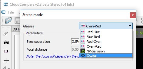

I think I've installed the non-stereo version (02/12/2016) - but it still has the stereo button in the toolbar?
Re: Label moving
Yes, but it only handles 'anaglyph' stereo (with red/blue glasses) and maybe the NVidia glasses, but not the Oculus device.

Ah, Have I mixed up my installations?
Can they co-exist on the same machine if installed in different directories?
Non stereo version: [img]
[/img]
stereo version:[img]
[/img]
Re: Label moving
Can't remember but you'll probably have an error message if you try to use the Oculus mode if you use the non 'Stereo' version.
