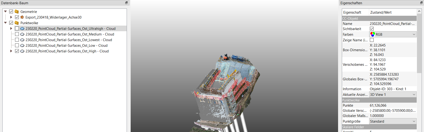

I have registered the Point Cloud with Ultra-high Quality, with seems to have then the global coordinates of the mesh model:

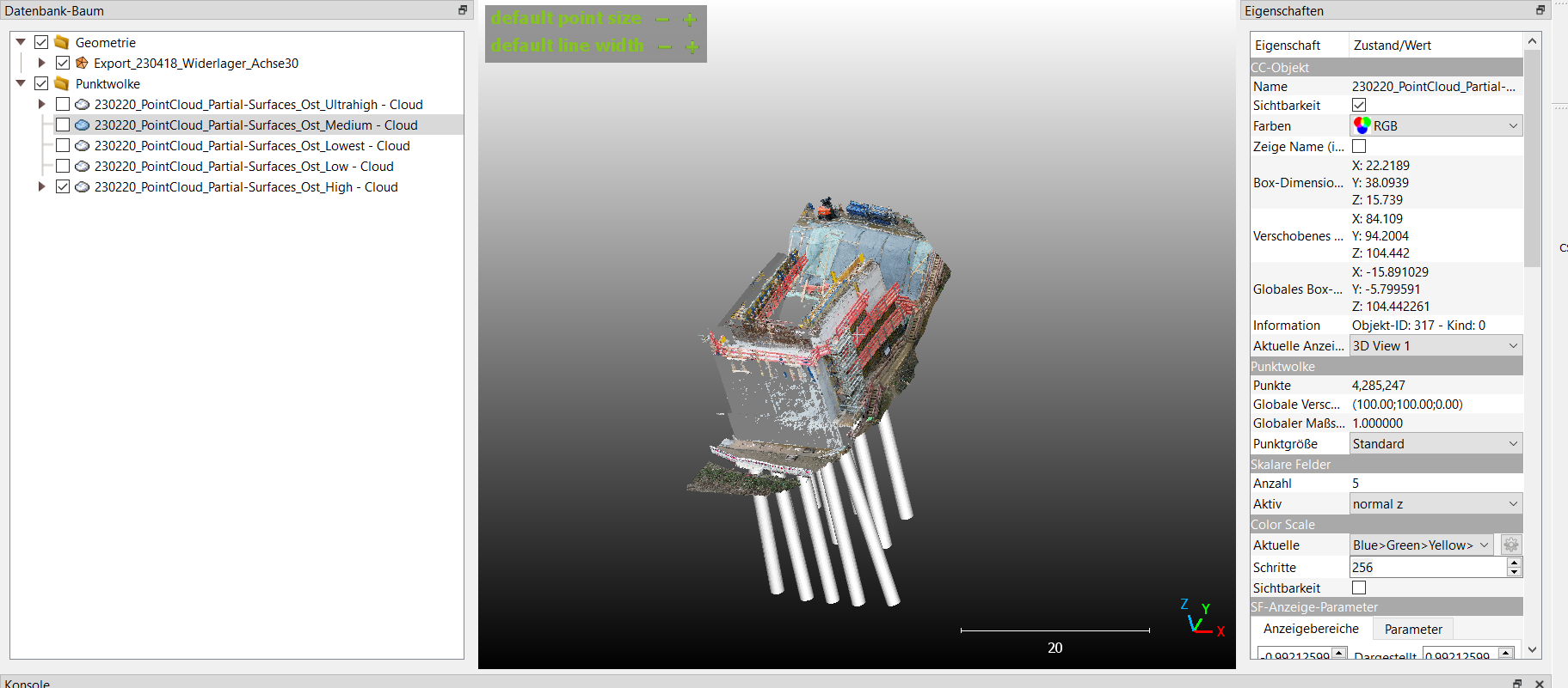

Then, I applied the transformation matrix of the previous registration to the others point cloud, but then they don’t have the global coordinates:
Any ideas? Still want the CC file?
Re: export of aligned point cloud to mesh with geo coordinates
As discussed via email, your issues came from the fact that the registration matrix output in the Console was transforming from a local to another coordinate system (as both entities were shifted). I changed the latest 2.13.alpha version so that it also outputs the matrix from local to global CS.
