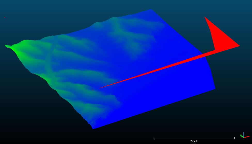

Hi, I installed this time from the zipped beta and I was able to replicate your ressults, certainly feel better!!
There are still on corners some non interpolated areas
Not sure if this is specific to this tile , I'll do some test with other tiles and see what happns.

I understand but I think it would better in case there is not enough data, to set problematic pixels to closest known value instead of leaving them "red" like in this heighmap
