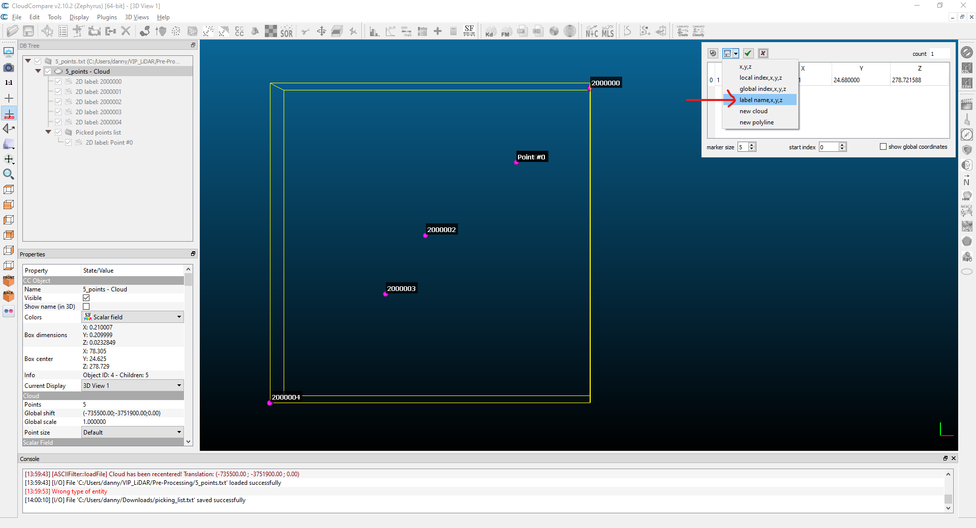

The first column is the unique identifier that I want to be labels. The next 3 are xyz in meters, and the last is a scalar. If I load this into CC, then it generates 2D labels for each point.

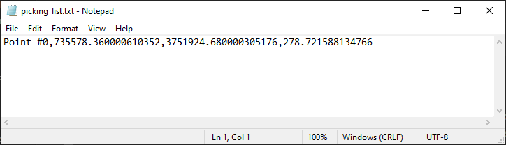

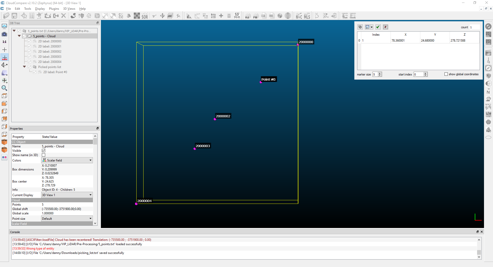

When I go to point pick, say point 2000001, then it puts it in a list but gives it a label of Point #0.
I go to export it and I choose the option "label name, x, y, z" and it exports it with the label name as "Point #0" instead of "2000001".
So I'm not quite sure if my issue is that:
1) My numerical labels are being imported as text.
OR
2) There is a bug and when you select "label name, x, y, z" to export points it doesn't actually export the labels, but rather the local index.

If you chose 'Label' in the 'ASCII Loading' dialog, then indeed, the values or text will be imported as '2D Labels' in CC (and considered as text). 2D Labels are actual entities, below the cloud, but they are more or less independent.
When you use the point picking tool, it only applies to the cloud. It doesn't care about the potential 2D labels associated to the cloud. So it creates its own label (from 1 to N). And those are the labels you can export afterwards (it's probably confusing ;). It's not a bug.
