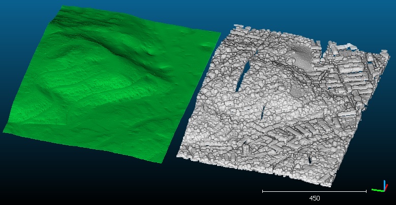

I just updated the plugin (same link as before):
http://www.cloudcompare.org/release/Clo ... bin_x64.7z
I used CC's octree instead of CGAL. On the rasterize and distance calculation steps, it goes almost 10 times faster (also because CC's octree is doing things in parallel). CC's octree could be even faster if it was able to work in 2D, but sadly it's 3D only for now.
(You can still revert to the old code by checking the 'QCSF_CGAL_SUPPORT' option in CMake).
I also added an option to export the cloth mesh at the end of the process (I was curious ;):
