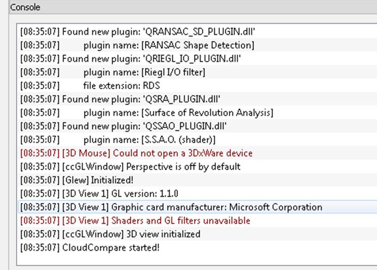

when I log in via remote connection to my computer at work CC 2.7 does not start (as mentioned). I can also confirm (as others mentioned in other posts) that if I launch CC 2.7 directly from work it works fine, and I can see it from remote too - but I cannot launch it from remote. If I launch CC 2.6.2 from remote it shows the following Console ...

- CC_console_remote.jpg (62.81 KiB) Viewed 24505 times

Re: 2.7 with windows 10 dosn't start
Daniel,
Solution was in setting NVIDIA as default graphics processor (or selecting NVIDIA if run / Run with graphic processor and selecting NVIDIA).
Encountered same with MeshLab, found this solution there, thought it might be same with CloudCompare - and it is working.
There should be a way to check this upon start and at least report problem to the user.
