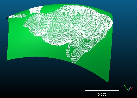

Full explanation of what I'm doing:
1) load scanned cloud of a distorted plane
2) fit a plane to the cloud
3) orient the cloud so that the plane is orthogonal to Z
4) fit a 2.5D quadric to the reoriented cloud
5) save the vertices of the quadric to a cloud named "vertices.txt"
run the following VBScript

Re: Flattening of a 2D surface
Forget about what I said yesterday! I totally missed the fact that we are already projecting the input points on their best fit plane prior to compute the best quadric. The result is that the equation is expressed in a local coordinate system that has nothing to do with the original one.
I've updated CC so as to display the matrix that will let you project the points between the two coordinate systems. And by the way, now that we do this I guess the dimensions/equation will always be z = f(x,y) (as the local coordinate system is meant to minimize the spanning along Z).
This time I tested everything ;)

Put simply, I'd like to detrend my point cloud using the quadric (below) before running some basic stats on it, e.g. detrended standard deviation of elevations, etc. I've already fitted a standard plane and oriented the data so that this plane fits the x,y dimension of the data (as advised), but I'm struggling to figure out how to then use the quadric equation/transformation to manipulate the point cloud to essentially remove the quadric curve signal.
Would you be able to explain the steps in a simple way, please?

Well, you may try this trick:
- compute the distances between your point cloud and the quadric (Tools > Distances > Cloud to Mesh)
- then convert the output 'C2M Distances' scalar field into the Z coordinate of the cloud (Edit > Scalar fields > Set SF as coordinates)
THERE'S A BIG APPROXIMATION CONCERNING X AND Y (they should be displaced as well). If your quadric is too curvy, then the distortion will be high.
It will also be slightly approximated because the quadric mesh is tessellated. But it's less severe and you can increase the quadric 'drawing precision' before computing the distances to increase the accuracy (depending on how important it is for your application).
P.S.: once done, you can remove the scalar field (or simply restore the RGB colors as the default color source).
