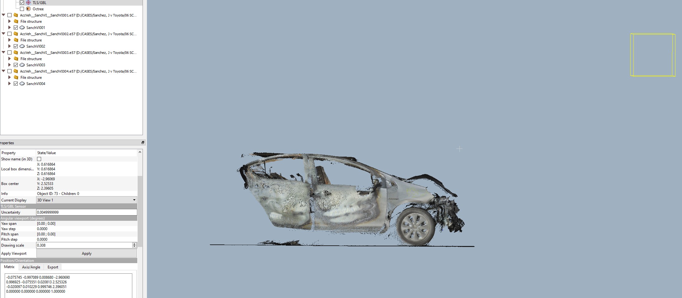

I had a chance to try it for a minute. It kind of works.
Looks like the 'sensor' position CC is generating isn't getting put in quite the right spot.
The scanner head data listed in the e57 exported from FARO scene:
<translation type="Structure">
<x type="Float">-9.36669992614051372e-01</x>
<y type="Float">1.90614000563962516e+00</y>
<z type="Float">1.19162517055379635e+00</z>
</translation
Hopefully these screenshots help. You can see the scanner head in FARO Scene and CC are in slightly different places. I didn't insert the screenshot twice. The insert attachment is just acting funky.

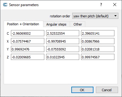

When you edit/modify the sensor object (Edit > Sensor > Edit) do you read at least the right 'center'?
Re: Create sensor from e57
Posted: Tue Oct 15, 2019 9:34 pm
by Laserbrain
I didn't know about that feature. Here are the sensor parameters for that same scan:
Posted: Thu Oct 17, 2019 8:38 pm
Interesting... I'm not sure where the difference comes from. Can you maybe send me your file? (admin [at] cloudcompare.org)
Posted: Mon Oct 21, 2019 9:08 pm
Ah, so I as feared it was a bug (nice catch ;) ).
I fixed it and updated the 2.11.alpha version.
