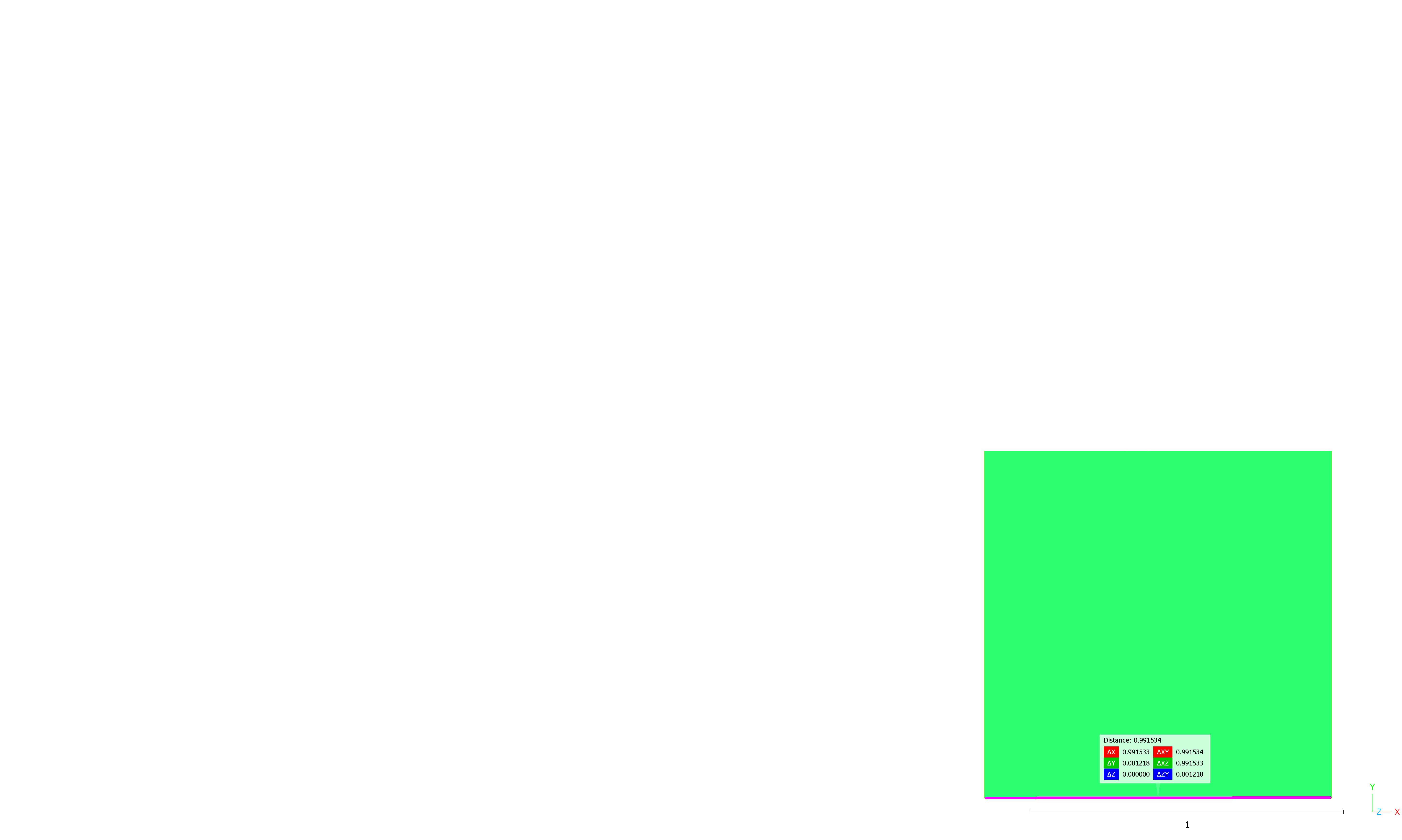

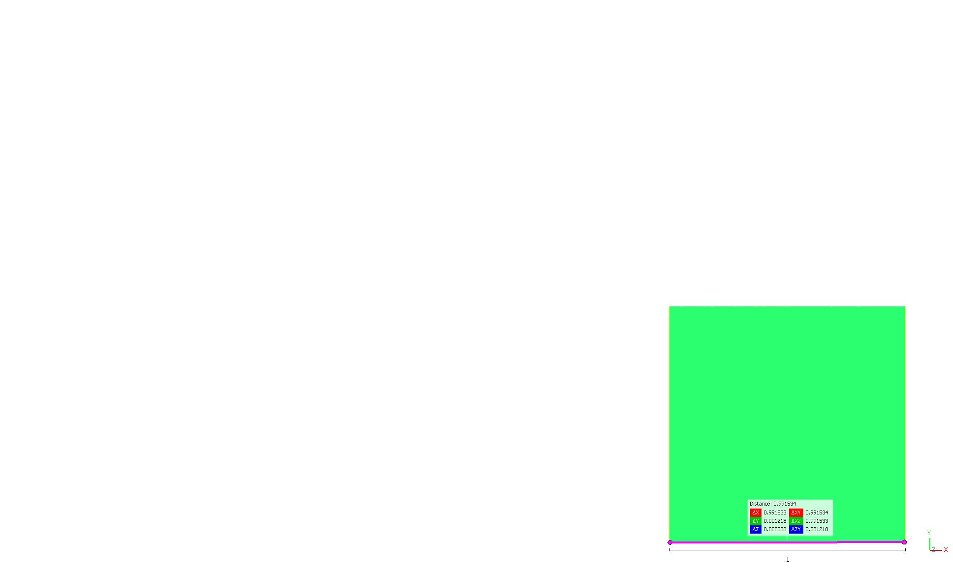

Re the Render to file option: the printed "scale bar" can be wrong.
the issue still exists: for zoom factors higher than 1 there is a scaling error on the "Render to file" image. Attached some examples (always the same 3D view).
CloudCompare 2.12.4
Best regards.
Re: Scaling problem
Good catch!
Guess I'll have to look at that again...
