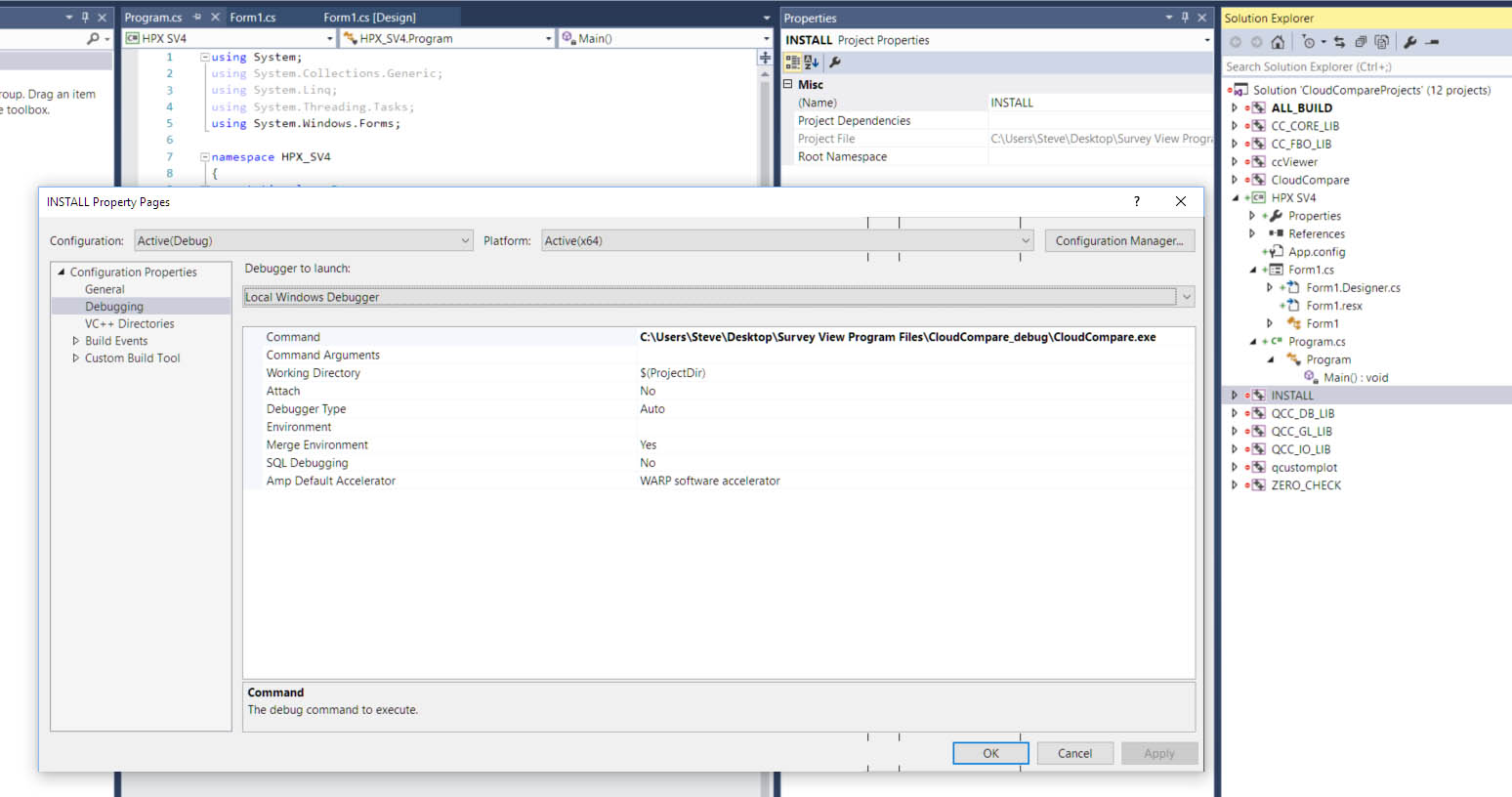

I have pointed the command line at C:\Users\Steve\Desktop\Survey View Program Files\CloudCompare_debug\CloudCompare.exe in the INSTALL Property Pages as per the attached screenshot. I theb Started without Debugging and get the same error.I have tried to find the CMAKE_INSTALL_PREFIX directory but cannot find it anywhere... ????

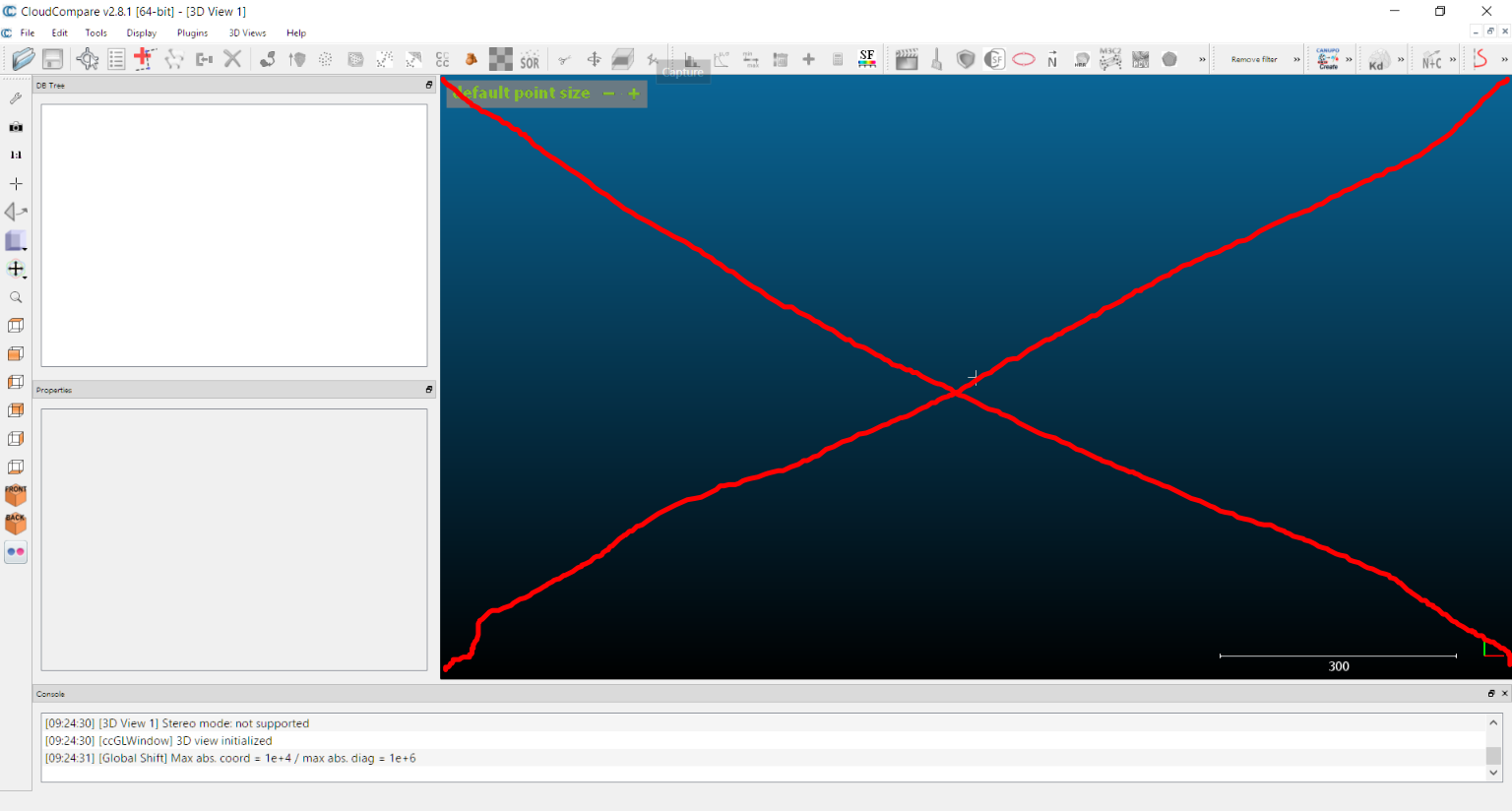

Also... If I want this panel with the red cross in CC to be viewed in a Windows form panel, where can I find the target to point the panel's method to?

1) The CMAKE_INSTALL_PREFIX is defined in CMake. It's where the compiled files should be installed (when compiling the INSTALL project in Visual).
By the way, make sure you have changed it (because it points on the 'Program Files' folder by default and you don't have the rights to install files there on the recent versions of Windows). This may be the issue?

I am trying to write a small program that will use CCViewer (or CC) to enable a user to start my program and within it load a point cloud x,y,z file into CCViewer . I have got the program to load CCViewer from within my program by running the CCViewer.exe file so my program and CCViewer are loaded. What I want to do is to obtain the values of a selected point from CCViewer and use those values in my program to work out which jpg images have the located point in their field of view. What are the values called that I can use as variables in my program and is this even possible?
Ideally I would like to have the CC window I have shown above with the red cross, to appear in a separate window within my program or just the CCViewer window.I want it to be as simple as possible and I also would like to disable the functions in CCViewer that would not be applicable so as not to give the user any functions they do not need. I have tried to edit some simple parts of the CCViewer program such as the 'About box' and it seems that it does not use any of my 'edits' (simple changes of text).
Any advice on how to do this?
Re: Access is Denied
Ok I remember now. But as I told you, you could relatively easily write a plugin for CC (with your software inside), but probably not the opposite.
