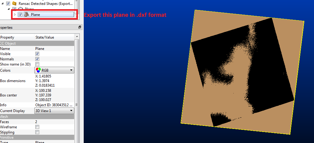

You can use the RANSAC tool http://www.cloudcompare.org/doc/wiki/in ... n_(plugin) in order to extract the planes.
Then, export your plane in .dxf format.

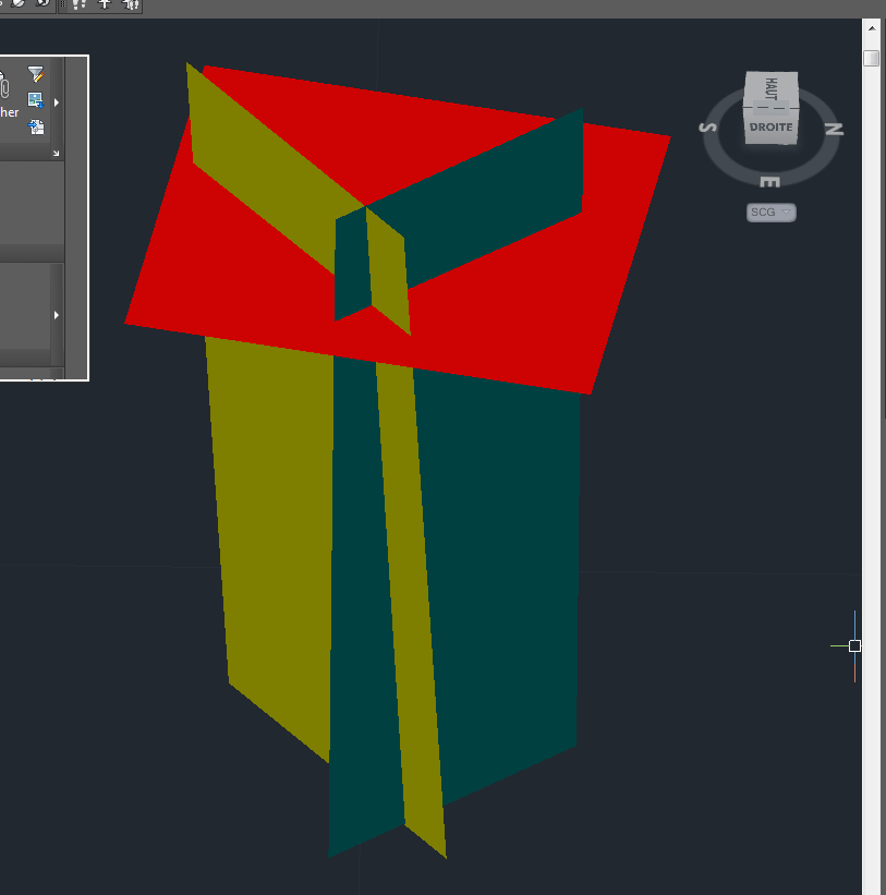

Then, open your planes with Sketchup pro (if you have Sketchup pro of course). Sketchup allows you to compute the intersection of three planes.
If you can't see any intersection between the plans, you can make them bigger in Autocad before exporting them in Sketchup.
Indeed, the scale tool in Sketchup makes the planes bigger but it also modifies the orientation of the plane. You have a bigger plane, but it's not the same plane anymore. Autocad doesn't modify the orientation, only the size.
