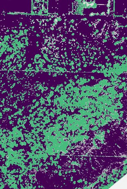

1) Please look at the first Figure below and notice the three horizontal lines. That's where I segmented my point cloud (into 3 parts) for classification. After classification when I merged the three parts back together I got these lines representing vegetation. Is there a way to avoid these lines?
point cloud classified. .jpeg (208.1 KiB) Viewed 7998 times

1) These lines may be due to border effects of the classification process I guess? If yes I don't know how to avoid this.

1) Yea, these are certainly the borderline effects. I'm wondering if these are due to edge artifacts induced by segmentation and merging without employing a suitable buffer? Is there an option in cloud compare to segment point clouds or surfaces with buffer?
