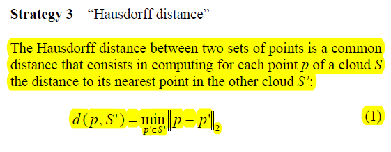

1. I have read your paper recently,and you mention the equation as can been seen in Figure 1. However, it seems that the equation is a little bit different from the definition of Haussdorf distance. The equation you mentioned in the paper only calculated the shortest distance between the compared cloud and the reference cloud. I would like to confirm if the CloudCompare use the same concept?

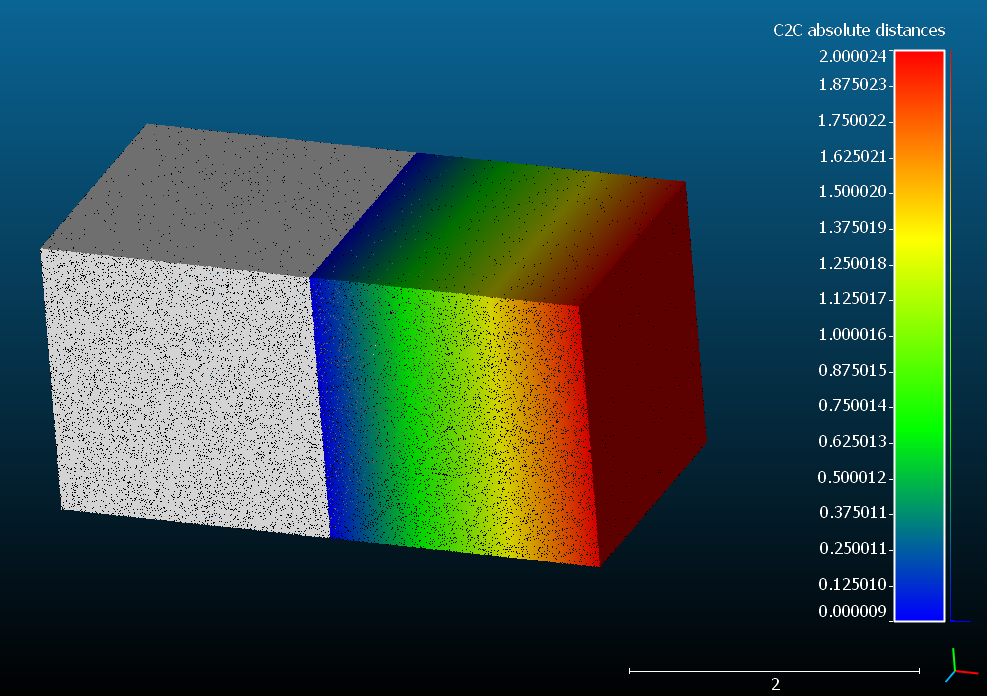

2. I intent to offset two cubes to analyze the C2C distance as shown in Figure 2. Each edge of the two cubes is 2 cm. (so I offset the compared cube 2cm to the right side of the reference cube). As you can see the result, it seems that the C2C distance only compare the compared cube with only right surface of the reference cube. Is there any way that CloudCompare can automatically detect the real surface (or points) that user wants to compare with?

1) This is not the shortest distance from the compared cloud, but only for one point 'p'. You would then have to take the maximum value over all the points to compute the actual Hausdorff distance. As I explained we do compute the shortest distance for all points, but we don't actually display or use the maximum value (even though you can get it directly when looking at the distances scalar field properties, or its histogram).
2) The C2C distances indeed computes for each point the distance to the nearest point in the other cloud (see above). Therefore the nearest point is always on the nearest side. To get a smarter behavior you should look at M3C2 (http://www.cloudcompare.org/doc/wiki/in ... 2_(plugin)).
