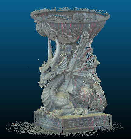

hey,
firstly I need to say that I have no experience with 3d reconstruction.
I have a 3d scanner that produces a point cloud of the object, I have downloaded a few programs that deal with point clouds like Meshlab, VRmesh(trial) cloudcompare and meshmixer.
some programs have basic guides/tutorials, others I cant find any info that helps to use them.
I have been trying for about a week to reconstruct one scan to a mesh, with little info and lots of trial and error(mostly error)

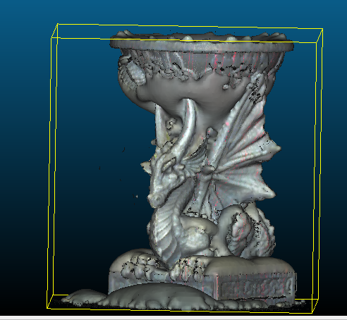

ive seen example pictures of clean and noisy normals but no matter what I have tried I have not been able to get them orientated correctly.
I am attaching a couple of images of my scan and what happens when I compute normals and then using poisson reconstruction.
I haven't cleaned this image before calaculating normals but it makes no difference to my results anyway.
I'm sure theres a lot to do before calculating the normals but I have no idea if I'm doing it right or wrong
I am working on trying to get better scans.
any help with the whole process would be appreciated.
poisson reconstruction.PNG (228.05 KiB) Viewed 16918 times

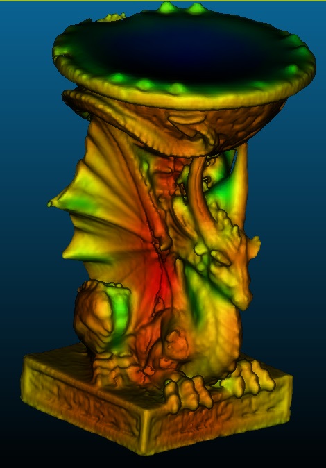

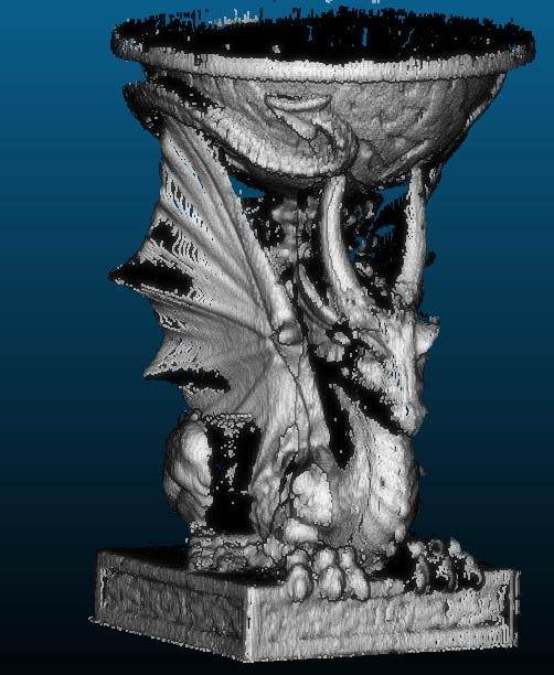

Okay, here is a procedure that gives "not so bad results":
  • As the cloud is noisy, I first used the SOR filter (default parameters). If you can reduce the noise beforehand it will be even better. You can also use the scissors tool to remove the biggest noisy parts (around the base for instance)
  • Then I computed the normals with a radius of 1 and the 'Minimum Spanning Tree' orientation algorithm with knn = 12 (it's always good to increase the number of neighbors when there's a lot of noise or complicated shapes).
The result is not perfect but with noisy/complicated clouds like this it's almost impossible to get 100% orientations correct. If you can compute the normals per scan (before registering them) it's definitely a good idea. Anyway, as long as only small patches are inverted Poisson is able to cope with it.
Here is the Poisson mesh (with density information - it can be used to reduce the mesh coverage on low density areas which are either actually empty or noisy due to the lack of information):
