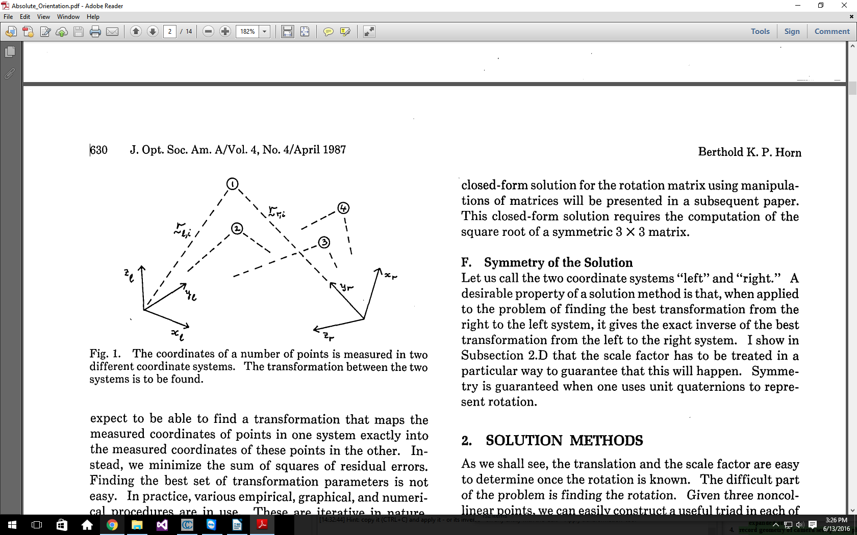

Thank you for replying. I will review Horn's algorithm. However, I am struggling to extract the information I need.
I am trying to determine translation and rotation displacements (x,y,z, roll, pitch, and yaw), ideally in units of mm and degrees from a common origin. I would like to be able to use the cloud compare transformation matrix to obtain these values.
1) See attachment. When the two meshes/clouds are registered in CloudCompare, are the coordinate systems brought together to a shared or mean point? Or is the reference mesh fixed and the data set moved to the reference? Could you please explain the process for the fine registration (not what is included on the manual, since I have already read that)?
2) What is the axis/angle tab representing when a transformation is applied? Do the x, y, z numbers represent a vector of the translated object? What is the angle representing?

- Untitled.png (167.67 KiB) Viewed 10798 times

1) the data / aligned entity moves towards the reference one (the reference entity is never modified in CC's registration tools).
The Fine Registration tool is simply the ICP algorithm with minor improvements. This is an iterative process where the aligned cloud comes a little bit closer to the reference one at each iteration. It uses the Horn algorithm at each step (each point is paired with its nearest neighbor).
2) the axis is a 3d vector (x, y, z). The angle is the rotation angle about this axis. Axis and angle are equivalent to a rotation matrix. And the last vector is the final translation (applied after the rotation).
