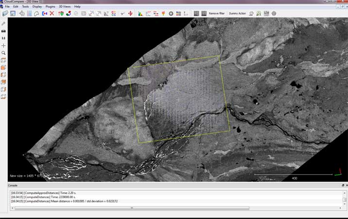

I'm really enjoying CC, definitly the best scientific freeware I've ever used. So I'm comparing LiDAR and TLS vs SfM (Agisoft Photoscan). I've attached a photo of the LiDAR in CC and my Svalbard block highlighted. I've also got a small scale experiment of a wall where a similar camera was used to get a point cloud and I scanned with a TLS. I just want to check something about the differencing. Here's what I'm doing:

My hesitations are about the difference in the number of points and spatial extents between my reference and SfM. If I understand this right, CC, in least squares mode, will, for each observed SfM point, fit a local plane with 6 points in the reference data and then, for each of those observed SfM point, calculate the shortest distance to that plane. So it doesn't matter that the reference data has a different number of points and it doesn't matter that the spatial extent of the reference data is much larger. Is that right? So for example, in the image I attached, CC will only calculate distances for those points nearest my SfM block. It will not include distances to the far reaches of the LiDAR data? And also, I do NOT need to subsample my reference data to the same size as the SfM data. Is that correct?

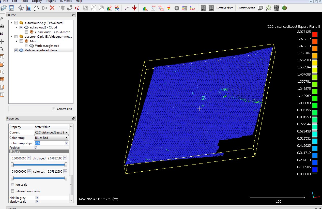

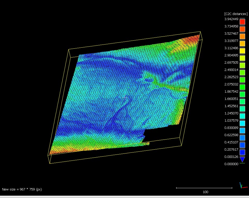

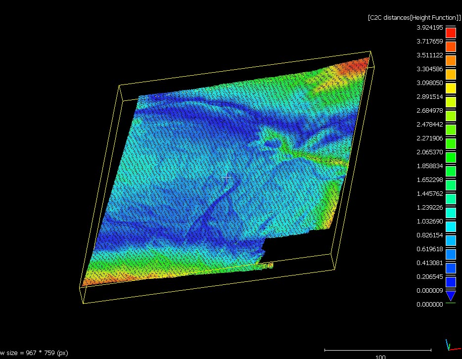

I've come back to this after my summer (in Lyon and Aix-en-Provence :) ), and now I see serious discrepancies between the methods used to calculate the C2C distances. Basicly, NONE and Height Function give similar results but they are about 10 times larger than the Least Squares Planes. In other experiemnts I get consistent results (small differences) when I use the 3 methods. Definitly not a factor of 10 in the sigma. I've attached screenshots of the scalar fields. What's going on here? The results from least squares do seem too good to be true...
Patrice

Re: Cloud to Cloud difference clarifications
Oups, looks like a bug. Or a very pervert case... I'll try to check this soon. Can you send me the two clouds? (or at least part of them if it's too big)
Regarding this issue, the cloud-cloud distances computation tool with local model has been improved. Now the user can set a lot more parameters. And the bug shouldn't be there anymore (at least I hope so).
