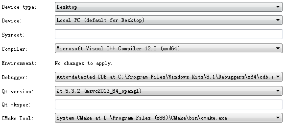

PS: I edit code and build CC with Qt Creator, and the compiler is Visual C++ Compiler 12.0(amd64)
Qt Creator Kits.PNG (8.4 KiB) Viewed 9899 times

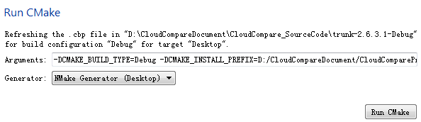

These are my steps when I build CC with Qt Creator :
1.Open project and select CC CMakeLists.txt
2.Qt Creator will ask you to select build directory and input arguments(e.g. -DCMAKE_BUILD_TYPE=Debug ...)
run cmake.PNG (6.09 KiB) Viewed 9888 times

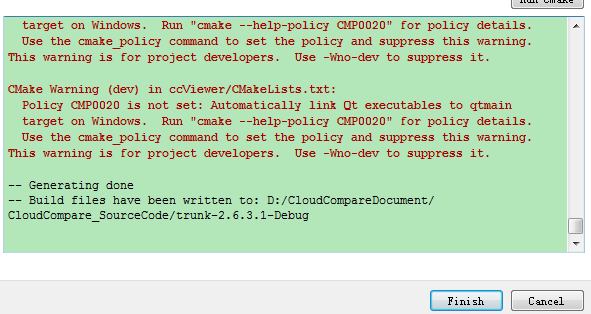

generating done.PNG (19.26 KiB) Viewed 9888 times

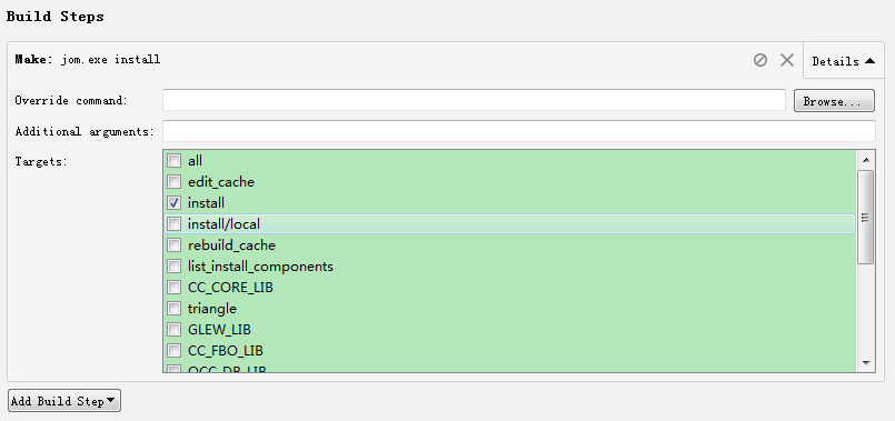

3.Configure the build steps
build steps.PNG (14.02 KiB) Viewed 9888 times
I build CC again, but the problem was not fixed.
I use CMake-gui to generate VS project, and build CC with VS 2013 in Debug mode. Then CC[Debug] loads plugin successfully.
I can't find out the cause of the problem. So I will use VS 2013 to debug CC's plugin. :)
