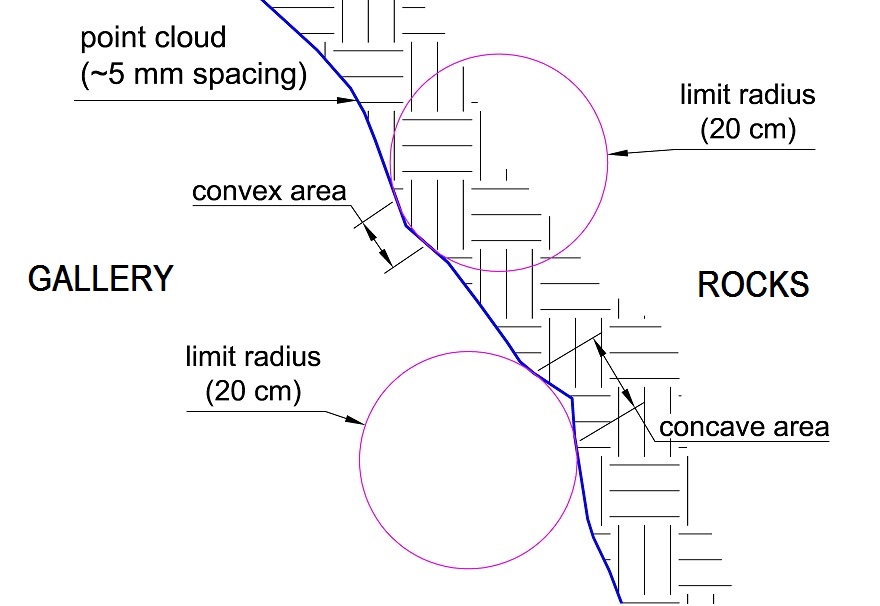

I would like to analyze the scans of some irregular walls and highlight the parts that have a radius of curvature of less than 20 cm.
The clouds are ascii files x, y, z, intensity (no normal), point spacing about 5 mm (see attached image)
I tried to use the tools in the Tools> Other> Bends> Gaussian / Mean / Normal rate change but do not know which function to use and what is the kernel value (the only data inserted by the user).
It is also possible to distinguish the concave areas from those convex?

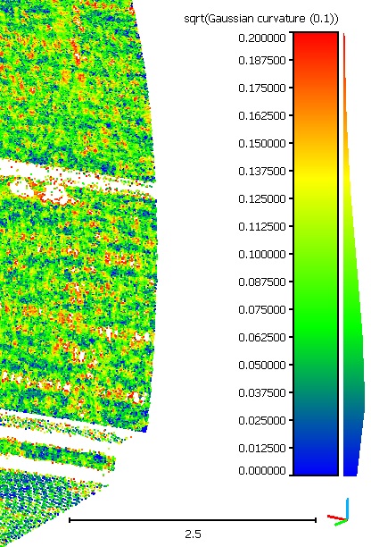

I bet the Gaussian curvature should be the most helpful (see https://en.wikipedia.org/wiki/Gaussian_curvature) but you should take the square root of the result to get something approaching (you can use the 'SF Arithmetic' tool to do this).
The mean curvature (https://en.wikipedia.org/wiki/Mean_curvature) is more directly equivalent to a radius of curvature, but it's also less robust.
The kernel radius is the size of the neighborhood that is extracted around each point in order to estimate the curvature. The bigger it is, the less sensitive to noise the measure will be (but it will also be smoother). And if it's too small then there won't be enough points to compte the curvature (and you have to be sure that the data is noiseless).
Setting it correctly depends on both the density of your cloud and on the range of curvatures you are interested in. I bet you could set at least 5 cm here?
And last but not least, the curvature measures are all unsigned. Therefore you can't differentiate the convex and concave areas...

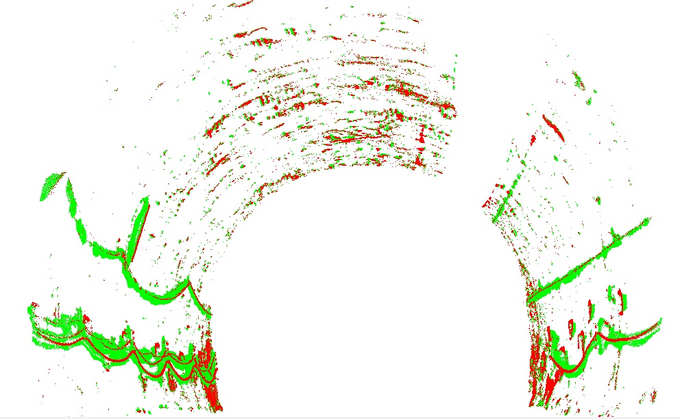

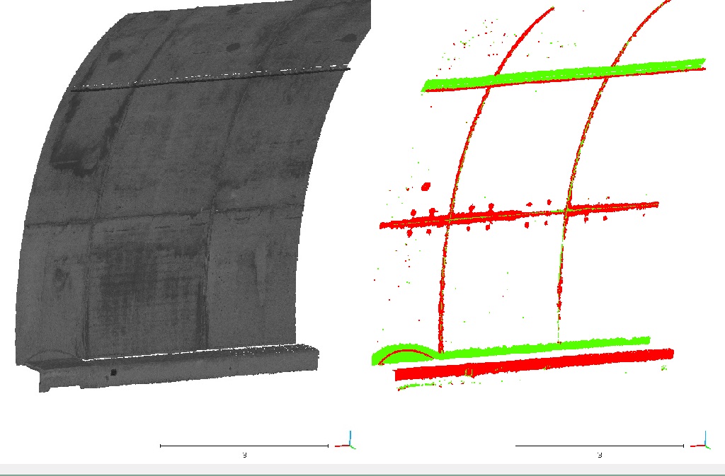

I tried both methods gaussian sqr and mean with similar results and some problems: they do not work well near the corners and i think they are very sensitive to the noise of the scanner providing curvature values of areas that should be flat and smooth; for this i thought of an alternative method:
I have created a matrix of points around the cloud to be analyzed, selected the points at 20 cm from the latter and divided into external and Internal with the cutting tool, then i calculated the distance of the cloud of relief from internal and external clouds and ighlighted the points more distant than 20 cm.
Is a very slow process, i hope that you can automate it creating for example an offset tool for the clouds.
regards
Alberto

Re: curvature analysis
Interesting.
You say that the curvature computation methods are very sensitive to noise. That's true but especially for small kernels. Have you tried big ones? What is the maximum you tried?
Otherwise they are made for smooth surfaces, therefore corners are indeed badly taken into account.
I tried with 10 cm on a section with very smooth walls and the result seem strange (i could be wrong), i attach the WeTransfer link to the cloud if you want to play with it:
