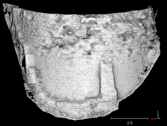

My team and I have a point cloud of a castle and we would get a uniform texture to redraw stones. The problem is that these towers are very collapsed and seem neither cylinders nor cones. I have no idea of strategy to adopt in order to obtain a conclusive result.

Overall, we have a point cloud Image and we want to get a texture to draw, with illustrator, this kind of thing: Image
Do you think this is possible?

Oh now I understand. You want to 'unwrap' the cloud along the wall lines? And get a single '2D' cloud.
There has been a similar question recently. CC can do this if you can draw a 2D polyline (from above) corresponding to the walls baseline along which to unwrap the cloud. However this function is now accessible to the user (it is used internally by the 'Extract sections' tool). Can you share the point cloud with me? (cloudcompare [at] danielgm.net)

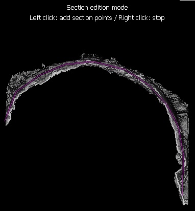

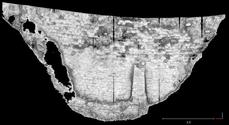

Okay, the tool is ready. This is a neat addition (especially as it was already there and I hadn't to do much ;).
It is based on the 'Extract sections' tool (http://www.cloudcompare.org/doc/wiki/in ... t_Sections). Therefore you might want to learn a bit how to use this tool first. Basically it lets you load or draw 2D polylines on top of your cloud (you can choose the vertical direction as being X, Y or Z which is the default). Then you can either extract the points close to these polylines, or extract the contour of the cloud in the 2D planes defined by these polylines.
And now you can 'unfold' the cloud along a polyline!
Here is a rapid walkthrough:
1. prepare your cloud: I removed the vegetation for this demo, and I made sure the walls were almost vertical.
2. Start the 'Section extraction tool' and start drawing the wall baseline right away (as a polyline). Don't forget to right click when you've finished to draw the polyline and then leave the 'polyline edition' mode by clicking on the first icon:
3. Click on the 'unfold' icon.
4. CC will ask you to specify a maximum distance to the polyline (this is to get rid of points very far from the baseline, but you could of course set a very big distance if you want to be sure to keep all the points of your cloud). And that's it. All unfolded clouds will be exported to the main DB (you can use the 'Section extraction' tool on multiple clouds at once). Just close the tool to access them.
P.S.: you can also save the polyline for later use.
