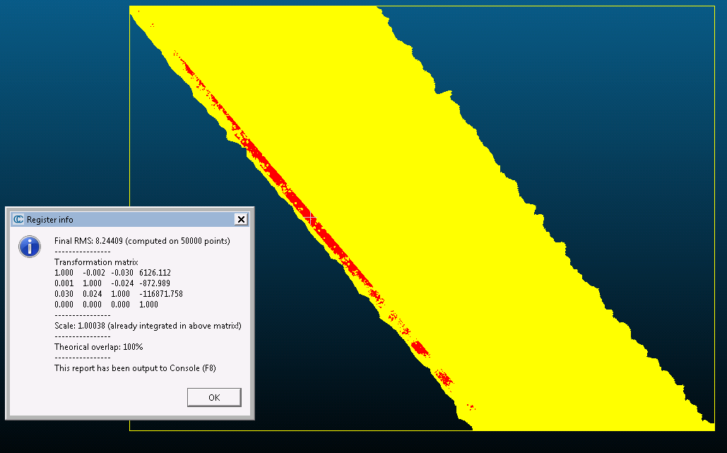

This first screenshot shows the swath of points cropped from the agisoft model after registration to the lidar point cloud - as well as the registration info/matrix.

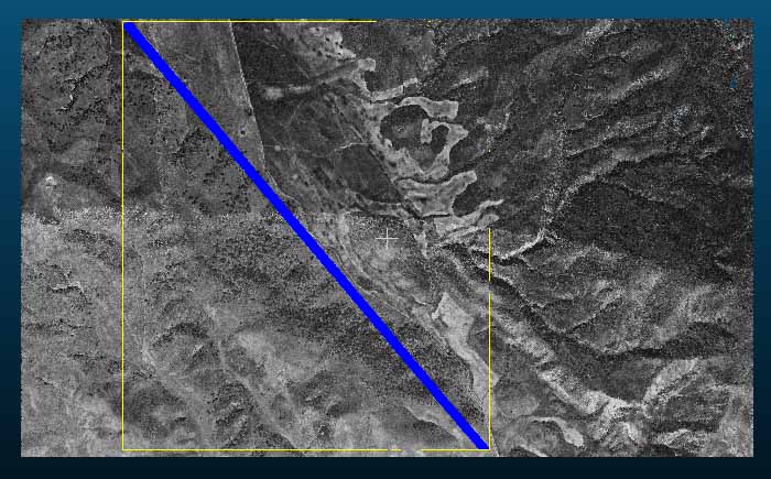

This second screenshot shows the coverage of the agisoft swath relative to the full dataset. I finally did the division and found that the swath covers 1.4% of the full model (based upon # of points) and so set the overlap to 1%. And again, the swath is derived from the full dataset and no projections, etc. have been changed between the two, so they should be lined up pretty well already - with the only difference being the small adjustments made in the alignment to the lidar point cloud.

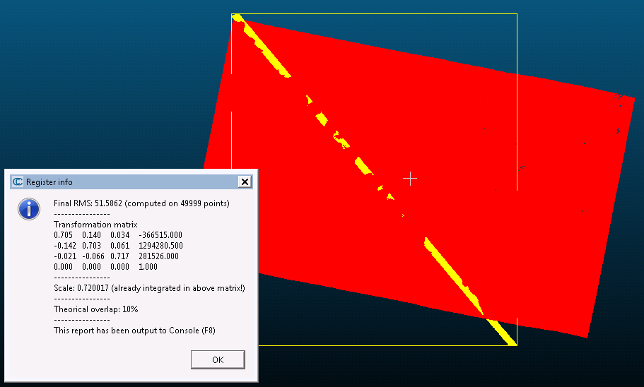

And this is the typical result after fine registration with the corresponding transformation matrix.

Are you really trying to register the big red cloud with the very thin yellow one?
If yes then part of the issue here is that CC will ignore a coverage below 10% (you can see this in the report dialog). And the fact that you can input such a small coverage is definitely an error! Anyway this is because it was normally unlikely to happen (using such a small overlap is generally not a good idea ... apart if your cloud are already well registered... which is your case).
For this reasons, but also for the sake of efficiency, you should definitely do the registration the other way around. Then:
  • copy the resulting matrix (select it in the Console and use the 'CTRL+V' shortcut)
  • select the red cloud
  • paste the matrix in the 'Apply transformation' tool and check the 'inverse' option
This will make the red cloud go to the right position (and you can delete and reload the yellow one).
P.S.: and in the case you are in fact trying to make the yellow cloud move relatively to the red one, then the overlap is 100%.
