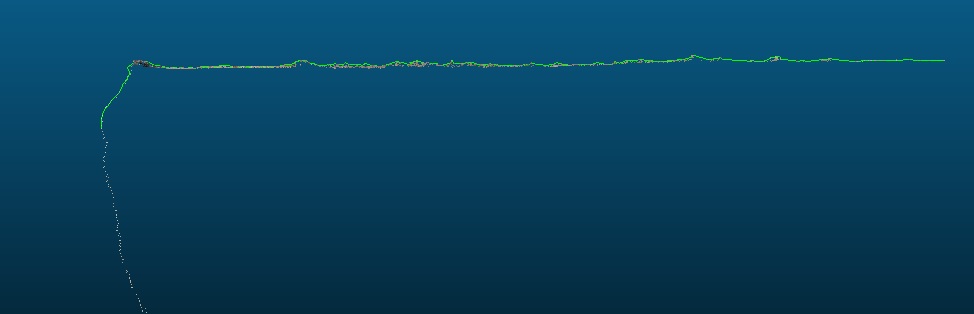

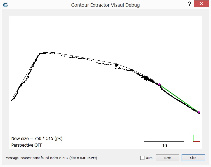

Okay, I looked at the first slices you sent me.
I got globally good results with the 'Section extraction' tool (max edge lenght = 0.4)... apart for a few "details" ;)
  • in presence of outlier points:
  • or more generally when the "overhang" is too strong: this is due to what we consider being the 'upper' and 'lower' profiles. In effect we look for the left-most and the right-most points and then we split the full contour in two parts relatively to those extreme points.
A solution in this case is to rotate the cloud of 45 degrees. But I concede this is not always easy (maybe we should add a parameter to let CC do this automatically for each section?).

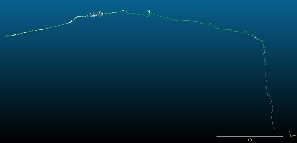

For the last dataset you sent me (cliff_7_trans133), I found this same 'overhang' limitation:
Which can be overcome by rotating the cloud:
Maybe we should change how the 'lower' and 'upper' profiles are determined (but how?). Or simply add a systematic rotation parameter...
