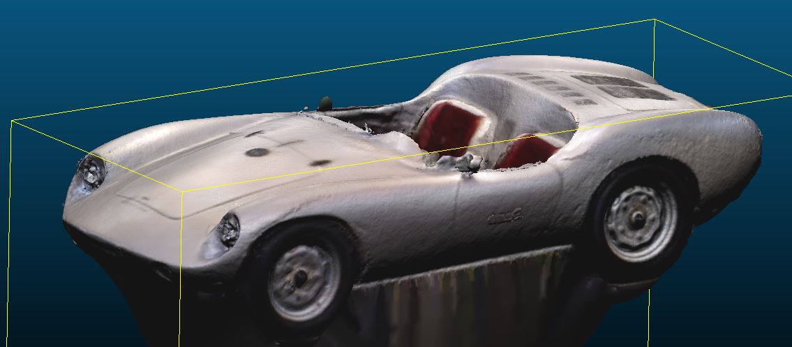

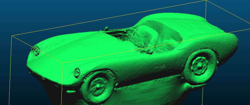

Please forgive me if I'm asking maybe another stupid question, but I'm currently struggling with another problem. When I create a mesh based on a point cloud (with Poisson surface reconstruction), I'm asked if I want to import the colors. When I click on "yes", it works and shows me the colored mesh (picture 1). But when I safe this file as an .stl and open it again, I can't see any colors at all (picture 2). Can't this information be stored in this file format, or am I doing something wrong?

Exactly, neither STL nor OBJ can save per vertex colors (especially not STL which is the worst format ever ;).
You have to save it as PLY or FBX.
P.S.: you should compute the 'density' (see the PoissonRecon plugin dialog) in order to remove the 'bubble' below the car (see the wiki for more info).

Ok, that makes sense. So I guess I will better save it as .ply... I'll go on and test this.
