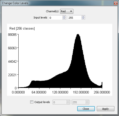

The second point is a very interesting idea. It may take some time but I'll try to figure out something. The very first step would be to merge the 'colors' and 'scalar fields' visibility parameters indeed. For the shader mixing 3 custom SF, the user might need to set the display and saturation limits separately for each Sf so the interface might be a bit 'heavy'. But I've added recently a new tool to change the dynamics of the color fields that we could re-use for scalar fields as well:
It gave me a lot of new ideas... thanks!
