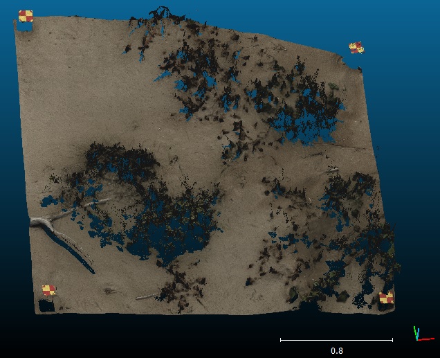

Ok, the issue seems to come from the way you created the mesh.
It seems that you have used the the 2D1/2 Delaunay triangulation method. The result of this algorithm can look quite good from above, but in fact it creates some wrong faces on truly 3D clouds or even on 2D1/2 clouds when there's big variations of height:
2D1/2 Delaunay triangulation issue
Those wrong triangles can really jeopardize the C2M distance. To properly mesh this kind of cloud you have to set a maximum edge length (something like 0.05 on your example) so as to avoid creating those big triangles on the sides:
2D1/2 Delaunay triangulation (best LS plane) with max edge length = 0.05
With this mesh, the C2M distances computation gave me the following result:
Cloud to mesh distance
Properly meshing the vegetation is almost impossible here so you still get strange 'inverted' patch near the vegetation or holes.
Maybe a good idea would be to remove the vegetation first (with qCanupo for instance ;). And of course M3C2 is clearly superior.

Hi Daniel ,
I have used Delanaunay 2D (XY plane) for mesh,
but also using other algorithms, the result is the same.
Now,I'll try the different solution, to use Canupo, to set a maximum edge length..
Actually using M3C2 there isn't this problem,
even if the end result is not what I would, graphically.
Probably it will be the most convenient solution.
thanks very much for your time!
Flavia

Using M3C2, if you select the option to output the standard deviation, you'll be able to remove from the results the area where vegetation affected the calculation (high standard deviation). Unless you manage to remove the vegetation with CANUPO (this implies creating your own classifier), meshing your data is likely going to give poorer results.
