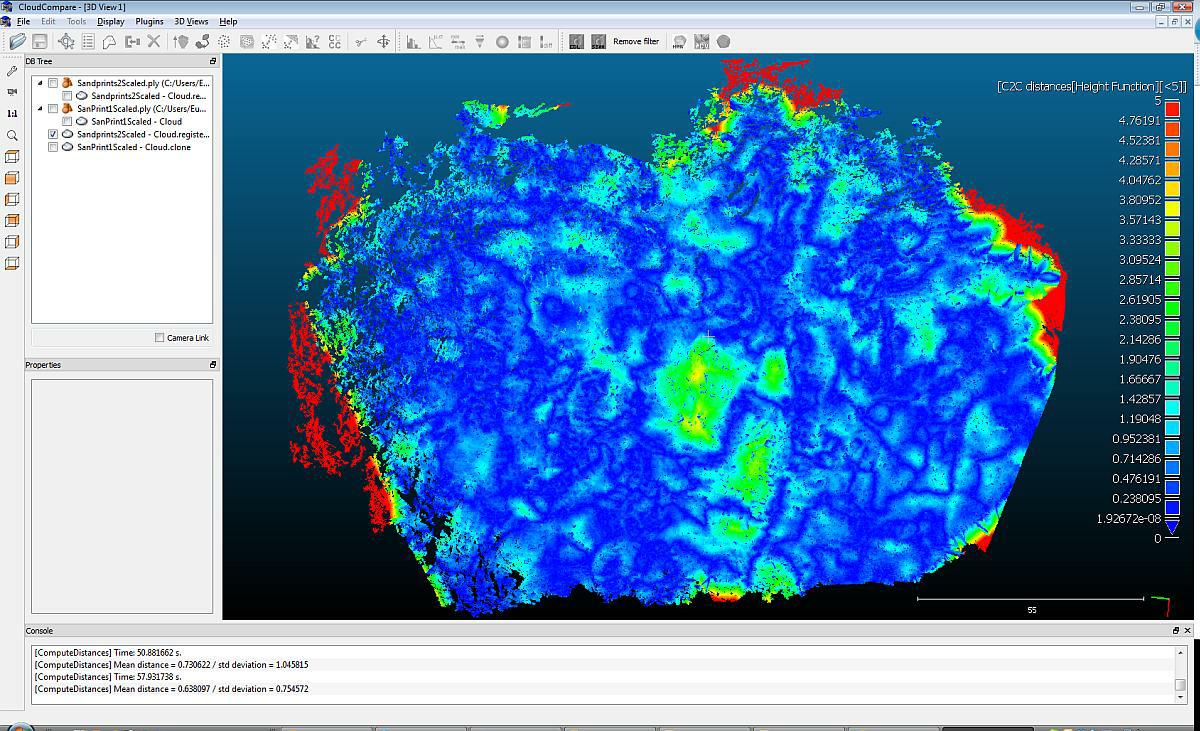

Following this I want to note the surface changes so I am using the cloud to cloud distance. I choose my reference and compared point clouds, but I am not clear on some of the distances and how they are displayed. For example, what happens when a part of the reference point cloud exists, but there are no points in the compared point cloud? I saw I had some high errors and am thinking that these were possibly from parts that had no overlap?

- If the point is far from any other point in the "reference" cloud because of a lack of data in this area, you'll indeed get big distance values that is clearly an outlier. The first thing in this case is to remove points that are not in overlapping zones (you can use the graphical segmentation tool - the scissors - to do that). This is clearly what we see on the borders of your dataset. Therefore, If possible one should always get a reference cloud as wide as possible, or at least a little larger than the compared zone (=safety border). Also, if you know approximately the typical differences span, then you can also "hide" the points with distances above a certain limit (with the color scale sliders). It will at least graphically remove the worst outliers. And of course, if you can produce a triangulated version of the whole compared cloud, you should definitely use it.

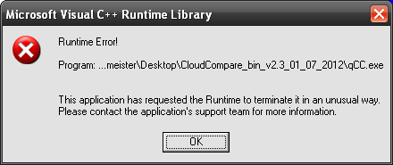

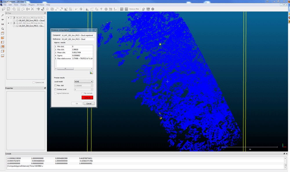

I´m really interested in this tool. However, it is not working. If I´m hitting the compute button the programm always crashes. Seeing the screenshot above shows me that it should work, particullary on Windows, but it doesnt.
Sometimes it is just a windows report, sometimes I see something about a runtime error.
Any idea?
I already tried a lot of different imports (from Ascii), registration and so on. But I only can see the pre-computation.

- Pre-computation Screenshot

what is the Windows version you are working with (Xp or 7, 32 or 64 bits ? + maybe the amount of available memory).
And maybe you can send me your dataset and I'll try it on my side (it's generally the best way to find bugs). Also, have you tried an older version of CC (there's always one at the bottom of the download page).
I'm waiting for your feedback,
EDIT: i've tested the last version of CC on several configurations, and I reproduced the issue on Windows 7 (but not on XP). I'll try to figure out the problem ASAP and I'll post a new version.

How can I display the legend like in the example of eliscio on the right side?

Ok..using another Local model then "NONE" leads to the runtime error also on the XP machine.

Ok, the issue has been fixed with the last released version (v2.3_01_18_2012 - see download page).
It was due to the fact that the progress bar was not thread-safe.
Thanks for the feedback.
Daniel
Daniel

- to display the color bar, you have to select the point cloud, go down its "properties" and check the "display scale" checkbox (you can only show one scale bar at a time). There's several options regarding the scale bar that are directly accessible in the same "properties" list. And there's more general parameters in the "Display settings" (the wrench icon or "Display > Display Settings")
