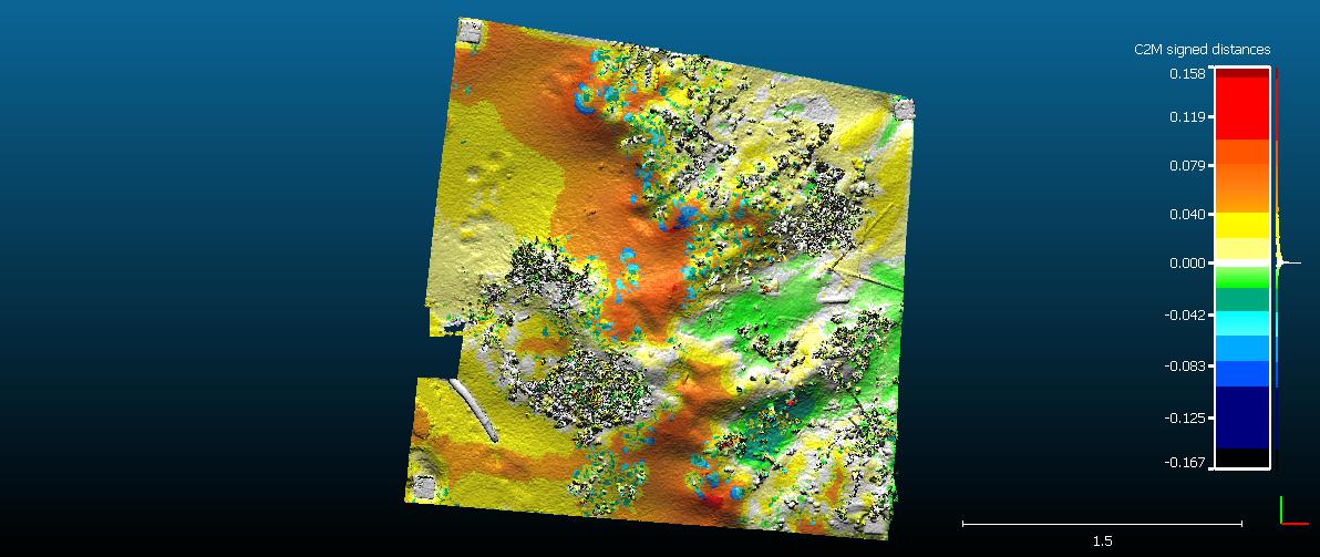

I use CC for monitoring the accretions/erosion of 6 small areas of embryonic coastal dune (by photogrammetric survey).
I have some questions, but I have to advance that I'm not very expert in the field, so my questions might be banal.
Anyway, until now I have used the M2C tool to comparing the clouds,
I apply the mesh transformation (XY plane, with original normals) on the #Cloud 1 (the oldest one)
but I have noted that some time the response cloud is strange, like in the cloud in attachment:
there are some azure-blue patches that seem to be artifices, mistakes,
because they are on a quite homogeneous accreting zone and the forms too are strange.
Do you know this problem and why?
Meanwhile I have tried M3C2 plugin .
there are no patch in the response cloud, the result are ok but, this time, I have a graphic problem:
the response cloud show the correct difference but, visually, it's like #Cloud 1!
I would see the #Cloud 2 (the latest one) at the end of the process.
I have tried each possible combination of data, but I can't get what I want.
How can I do?
What could be the best setting/parameteres, for both M2C, M3C2 tools, for my situations of natural sand surface with vegetations?
Thanks in advance

Hi Flavia,
there are various ways to get your results on the 2nd cloud:
. Case 1: you select cloud#1 as the first survey, and cloud #2 as the second survey, in the M3C2 interface, and in the output tab you select "cloud #2". Note however that in doing so the point cloud produced by M3C2 will not be exactly the 2nd cloud, but a slightly smoothed version of it (the level of smoothing depending on the projection scale you selected).
. Case 2: if you want to absolutely preserve the positions of the 2nd cloud (i.e. no smoothing), you must invert the selection of clouds: cloud #1 will be the 2nd survey and cloud #2 the first survey, and in the output tab select "keep original positions". By default (and this is not changeable right now), if you impose a vertical difference, the direction is positive towards +Z. This means that you'll have the opposite sign compared to doing the first operation.

flavia.sistilli
- Posts: 12
- Joined: Mon Jun 16, 2014 10:49 am
Re: M2C-M3C2. Some questions.
i'm sorry, excuse me,
i forgot to upload the image!
- BN1_19.09.14 vs 14.10.14_M2C.jpg (95.4 KiB) Viewed 12678 times
It's hard to understand exactly what's at stake, but those blue patches are generally due to wrong normals.
How does this mesh has been generated? Can you show it alone? (with normals activated)

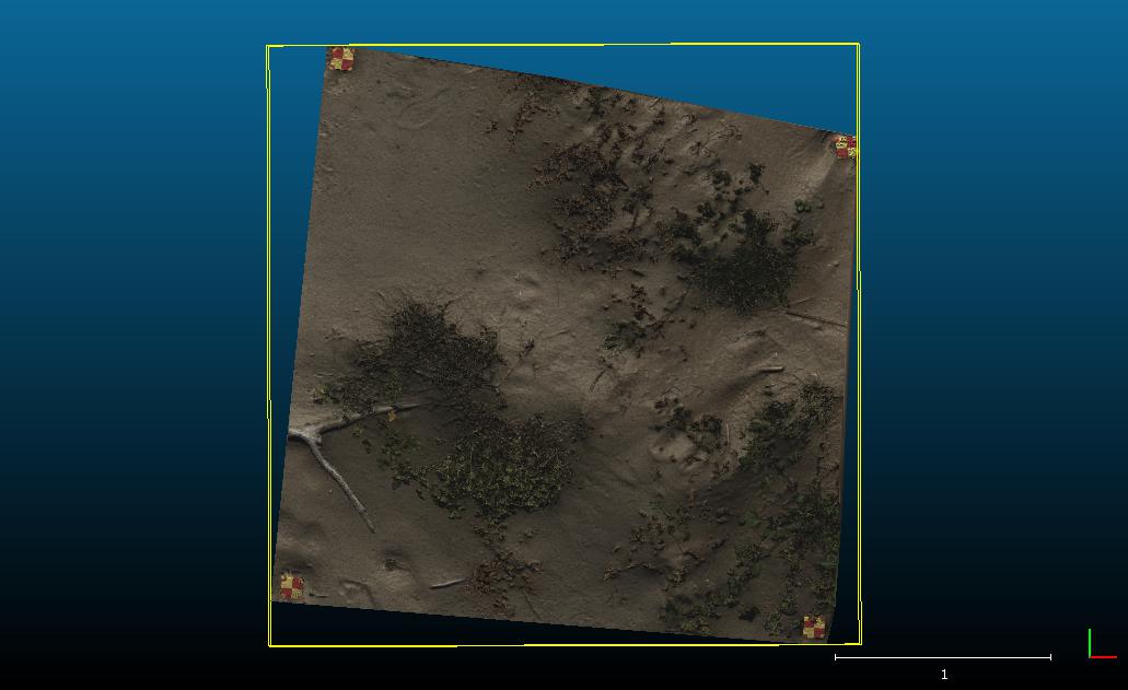

flavia.sistilli
- Posts: 12
this is the mesh that I used. (Is this? It's correct?)
Usually I use the tool Edit->Mesh->XY plane -> NO update normal
(because when I import the clouds in CC, they are already "cleaned"and "repaired" with Geomagic Studio).
However, I also tried to update the normals and to use "best fitting plane" mesh
but the results are the same.
Maybe I should re-Compute the normals in CC, before the comparison?
Could you post a snapshot (or even better: send me your file) of the mesh alone, and the cloud alone? If the gray (white/black) things I see are part of the mesh, then it looks clearly 'messy'.
