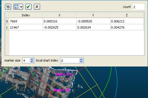

The other problem is in point picking list. When I pick a point, the shifted point are displayed in the point picking list. Even if I save this list in .txt format, then also the shifted coordinates are saved. I want to save the global coordinates of picked points.
I want to save global coordinates of the picked points.

And for the other issue, the absolute coordinates are not disabled by default (I'll add something regarding this in the TODO list) but the latest beta should fix the fact that the global shift was not applied at export time.

Also the other problem of point picking list is also resolved with the new version.
