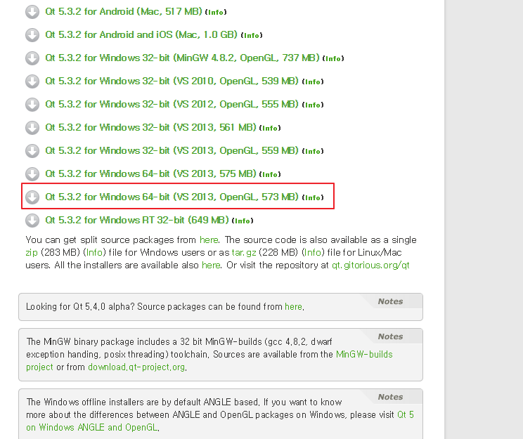

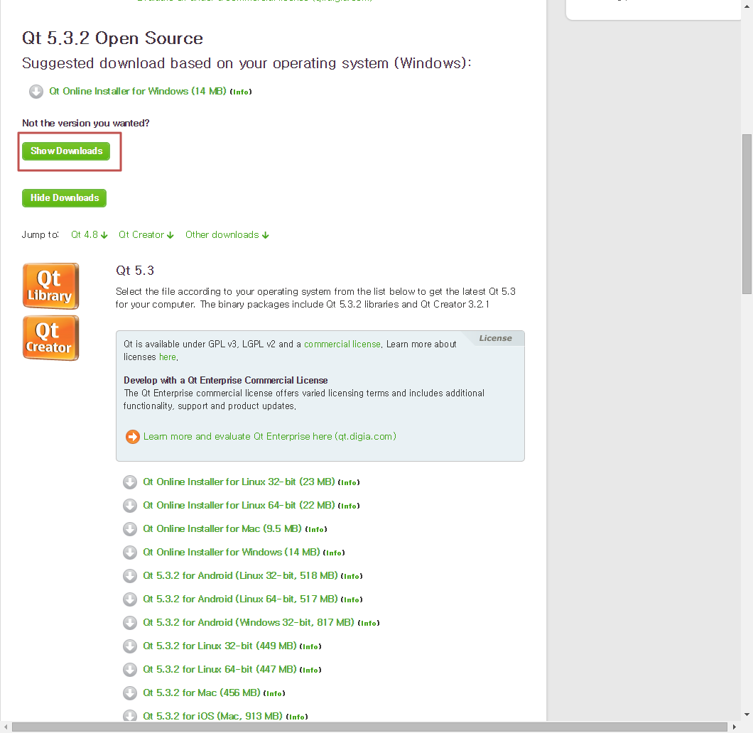

Thanks to Daniel, I found Qt5 version supporting OpenGL. For the beginners of QT like me, I attached the captured images.
Just find additional downloads, and download Qt 5.3.2 for windows 64-bit(VS2013, OpenGL,...)
Thanks.

Re: Build with MS Visual Studio Express 2013
Thanks, I've updated the compilation instructions on the wiki as well!
