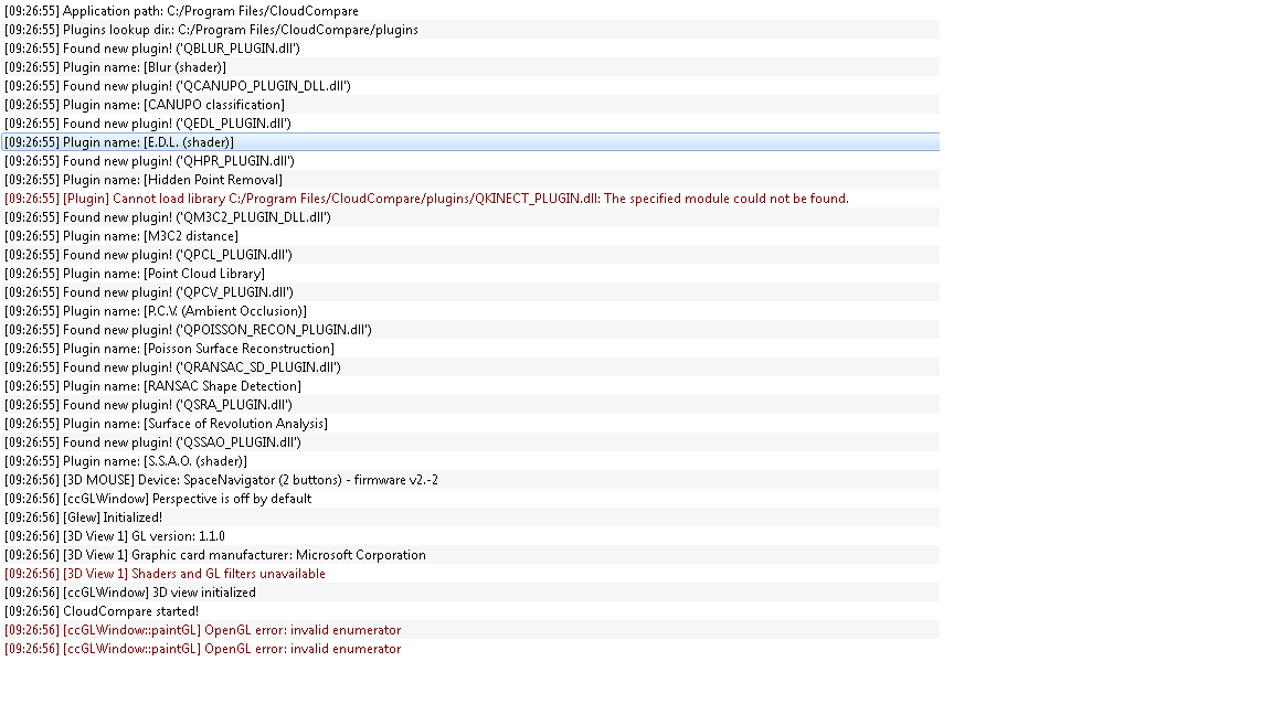

Daniel, Here is a copy of the consule under remote desktop. Mike.
Screen dump of consule.
Re: Point Picker Display Box and OpenGL Error
When using CC in remote desktop, what was the OpenGL version used? I bet it must be pretty low... We may not support version lower than 2.0 properly. And of course, those kind of 'drivers' are more likely to be buggy...
