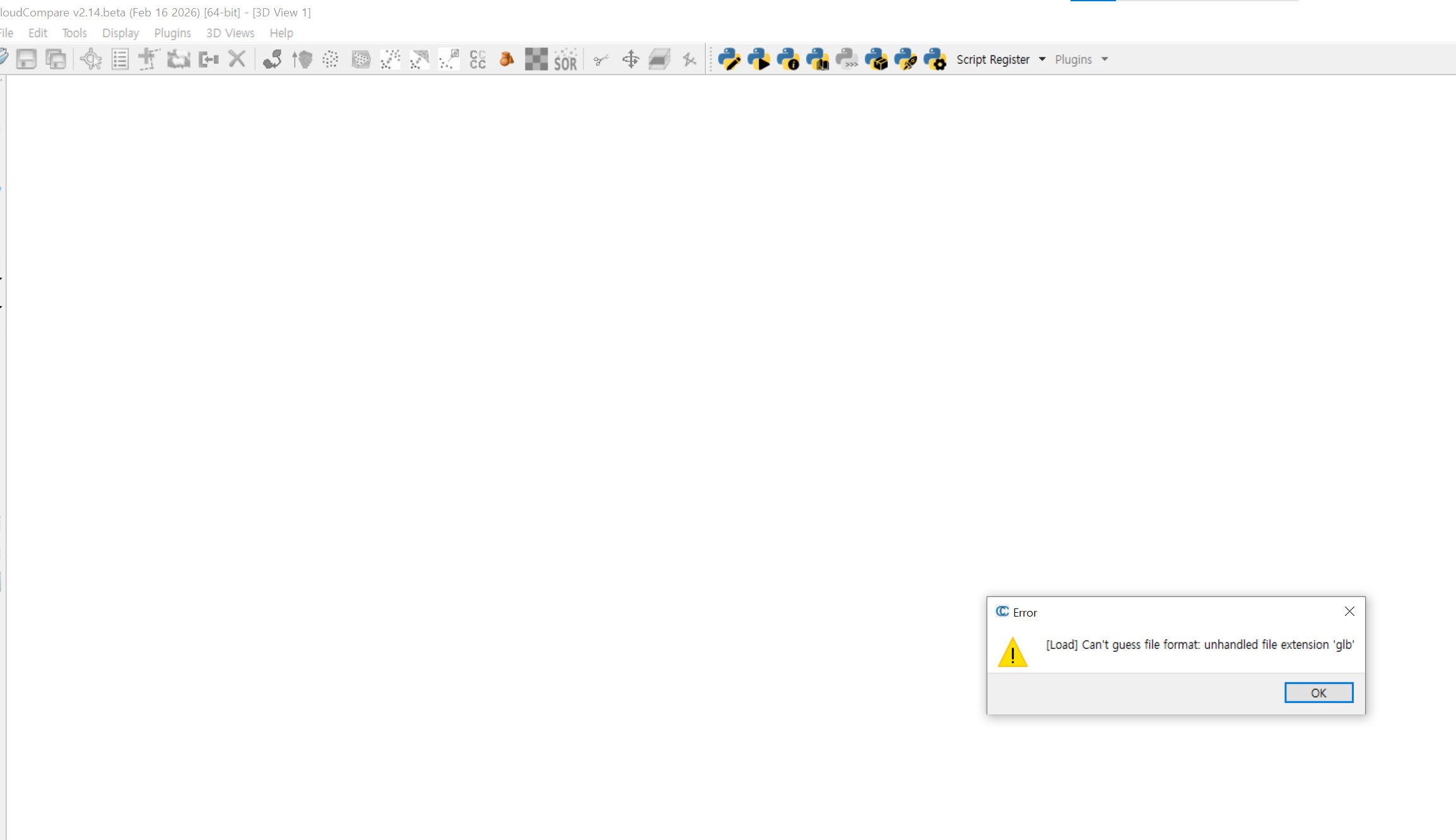

after 2.14 beta update,
CC can't read .glb file.
Please handle this issue. Thanks a lot.
issue abot .glb file.
Re: 2.14 beta can't read .glb file.
Yes, this format is not supported by CloudCompare. That's not an 'issue' per se ;)

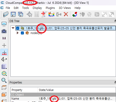

But previous version can open .glb file.
glb issue.png (33.33 KiB) Viewed 75939 times
Ah, it must have been managed by the Mesh I/O plugin then. This plugin was not compiling with Qt 6 anymore, but I managed to fix it I think (I haven't been able to test).
