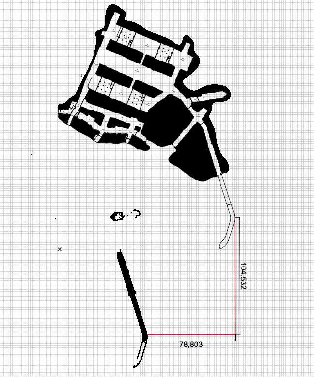

The problem is, when I import it to ArchiCAD, it doesn't land in the correct position. It's pretty close to the local origin, so it's not in SWEREF coordinates (which would mean that it would be much longer from the project origin), but it's not either shifted according to the numbers I put in.
It seems to be shifted around 78000 mm in the X direction and 104 000 mm in the Y direction - pretty random numbers not related to either the sweref coordinates or the shift I put in.
Screenshot 2025-11-18 at 14.59.24.png (73.46 KiB) Viewed 21637 times
