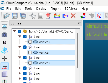

crash on merge 3 poly line points
DA523
Posts: 187
Post by DA523 »
Screenshot 2025-08-25 224958.png (34.35 KiB) Viewed 32999 times
atatched dxf file

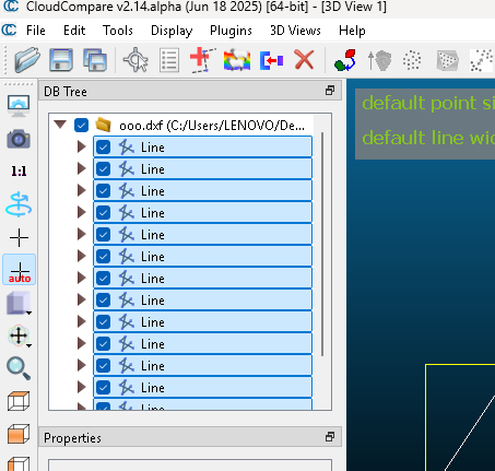

Post by DA523 »
Screenshot 2025-08-25 230936.png (43.64 KiB) Viewed 32990 times
also if sample many polylines ...cc crashs
Re: crash on merge 3 poly line points
Good catch! The first issue was already fixed in a more recent version of CC (merging polylines is actually not possible). But the second one was another bug. I've fixed it normally (see the latest 2.14.alpha release for Windows).
