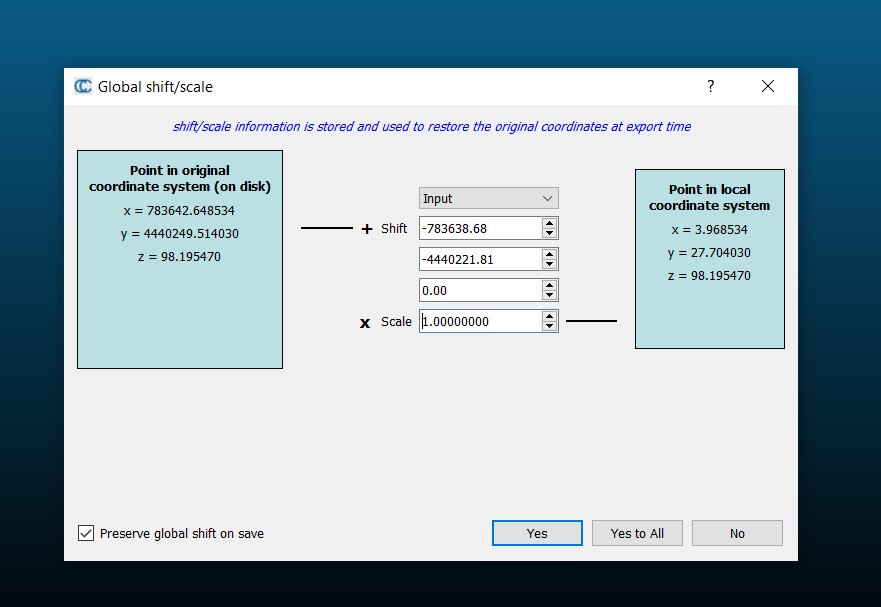

I tried with 2.13.2 Kharkiv (08/07/2024) and now I'm trying with the latest version 2.14.alpha (18/06/2025). But even when I start training the classifier, Cloud Compare starts lagging and doesn't work. Attached are screenshots of the global shift/scale and trainer setup. Am I doing something wrong? I am trying to train the classifier to automatically classify the slab from the rest of the elements such as floor, walls etc.

I've tried on my side (with a random test dataset that I used in the past) and it still works properly with the latest 2.14.alpha version.
Things to pay attention to:
- you have a lot of scales (about 20) and the largest ones span over what looks like a third or half of the cloud width (which means it will encompass a lot of points, and therefore take a lot of time to compute)
- you may want to lower the max thread count (to 6 or 7) so that your PC keeps responding during the computation. I guess what happens is that the computation takes a very long time, and what you perceive as 'stop working' is that the processor is too busy.
