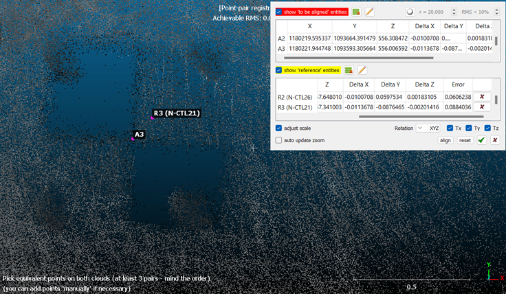

When you finish entering the references in the point cloud and click the align button inside the tool box, the cloud is aligned with the reference points (with their corresponding errors). However, this adjustment looks fine in plan and when checking the elevations of the point cloud (isometric view) they are all inverted except those at ground level.
Looking more closely, this occurs when using 4 reference points (not sure if more, not tested). When using 3 points, this situation does not occur -->

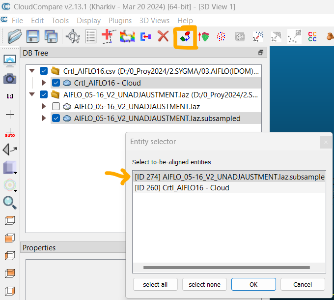

1. Go to the "aligns two clouds by picking" tool.
2. Click on the cloud to be aligned in the pop-up box to configure the reference order.

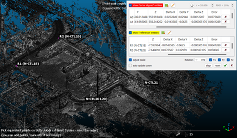

4. See the error when trying to align the cloud with four reference points.

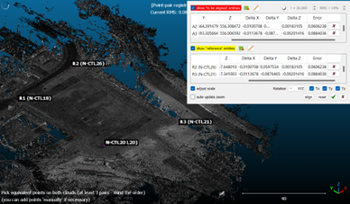

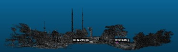

The following image reflects the adjustment made with three points, whose result was as expected (although not quite for the scanned area)
The following image reflects the adjustment made with three points, whose result is as expected (although not quite for the scanned area)

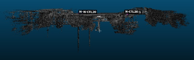

The result obtained (and not expected) even with acceptable statistical results (rms of approximately 0.08m), but when viewing the isometric view, all the heights were inverted.

Difference between log with four (Imagen3.png and Imagen4.png on the left) and three (Imagen5.png and Imagen6.png on the right) benchmarks
