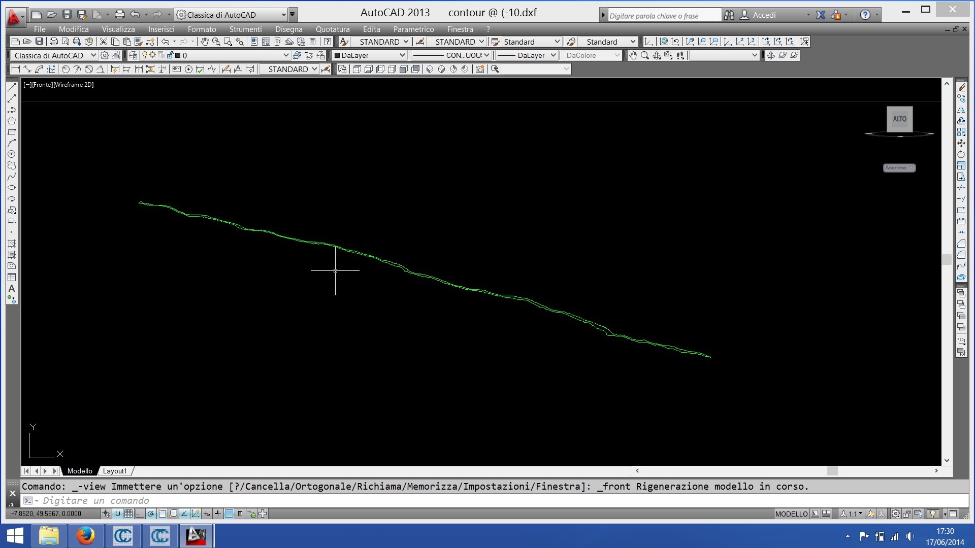

sure, i can open the contour as a polyline on AUTOCAD, but i can't for example join two points of the polyline with a line.
- rsz_x.jpg (216.34 KiB) Viewed 16478 times

i' m here with my Professor that follow me on this thesis and we both don't understand, because we are able to draw on AUTOCAD but we don' t understand why with this file when you click the comand LINE the cursor disappear and we can't track any lines. We thought that it could be a problem by the exporting with CC for ths reason we write you.

Hi Lucas,
i'm not quite sure that I really understood your problem, but so fas I can't reproduce the errors you describe (AutoCAD 2011).
If you want to join segments of the extracted polylines with newly drawn lines you have to make sure to use the same type of lines: CC exports the polyline as a "3D-Polyline", which differs technically from a "Polyline" (which is again different than a "Line"). For me joining the lines (with cmd "pedit") works fine as long as I use the same linetype.
Using Cloudcompare 2.5.4.1 with ACAD 2011 on Win 7 64.
If you still have problems just upload the dxf (please save as earlier acad version) and I could take a look.
Cheers.
