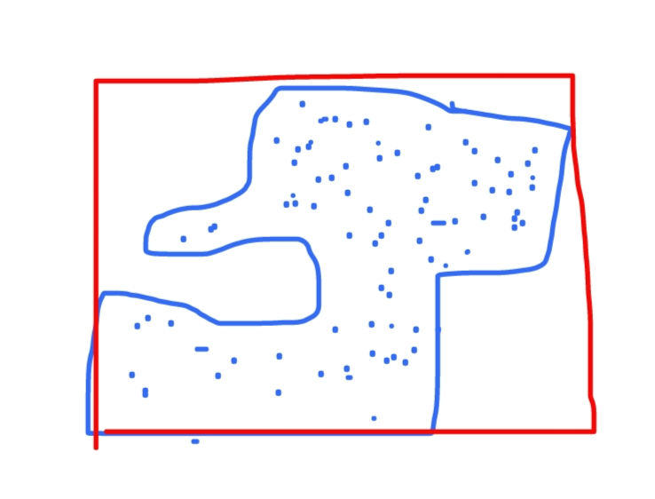

Most of the time, but not all the cases, optimum volume and area is when % of matching cells is close to % of shape area to area of containing rectangular (min x min y, max x max y)
and it is tricky
You can use try and error or visual inspection
Usually, you start with samll grid and increase till you get constant volume

DA523, the diagram is very helpful. Thank you for the easy-to-understand diagram and explanation.

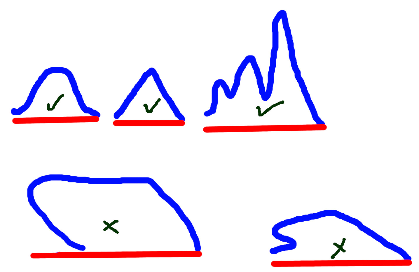

2.5d volume has limitations
Please check the attached example where 2.5d volume fails because 2 z levels in the same pointscloud
real volume=2.964 cubic units
Screenshot (308).png (90.41 KiB) Viewed 17921 times
2.5d volume fails.zip
(1.38 MiB) Downloaded 1578 times

Does this mean that the calculation will be incorrect if there is an overlap between top and bottom?
DA523
Posts: 187
Re: About Volume calculation Results
Post by DA523 »
2.5d volume between red and blue pointsclouds
x means 2.5d volume incorrect
SAYURI
Posts: 14
Joined: Thu Feb 15, 2024 4:20 am
Post by SAYURI »
Thank you very much!
It's a really easy to understand diagram.
I also came close to getting it correct.
