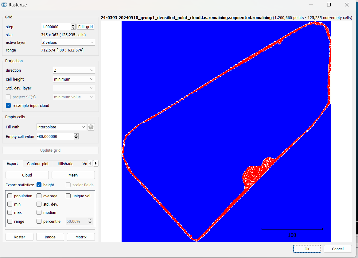

Using the 2.13.1 stable version and I've either encountered a bug or the interface has changed
Trying to interpolate across a pond surface, shoreline to shoreline and CC won't create points across the pond? Am I doing something wrong?
cc bug.png (61.55 KiB) Viewed 11740 times
Re: Interpolation bug under rasterize?
If you click on the 'gear' icon next to 'Interpolate', you should see a setting to set the maximum edge length. That's hopefully the issue.
Otherwise, don't hesitate to share the cloud with me so that I can test things on my side ([email protected]).

The older version of CC allows that value to be 0. The new version requires a value greater than 0.
Hum... you are correct! You'll have to set a high value for now.
I'll fix that for the next minor release of the 2.13 version (should be out in a few weeks).
