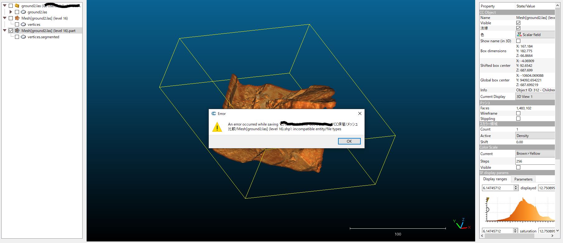

yes. I chose MESH.
This is an image of the error.
I would be happy if you could help me.
Re: Export mesh as shapefile
Ah, there is an extra condition to save a mesh. See the Console (F8), where you should see the following error message:
[SHP] A mesh has to be organized as a triangle fan or a triangle trip (see MultiPatch geometry specifications)
This condition is almost impossible to respect for an arbitrary mesh sadly...

It's sad, but I found out.
Thank you Danial.
