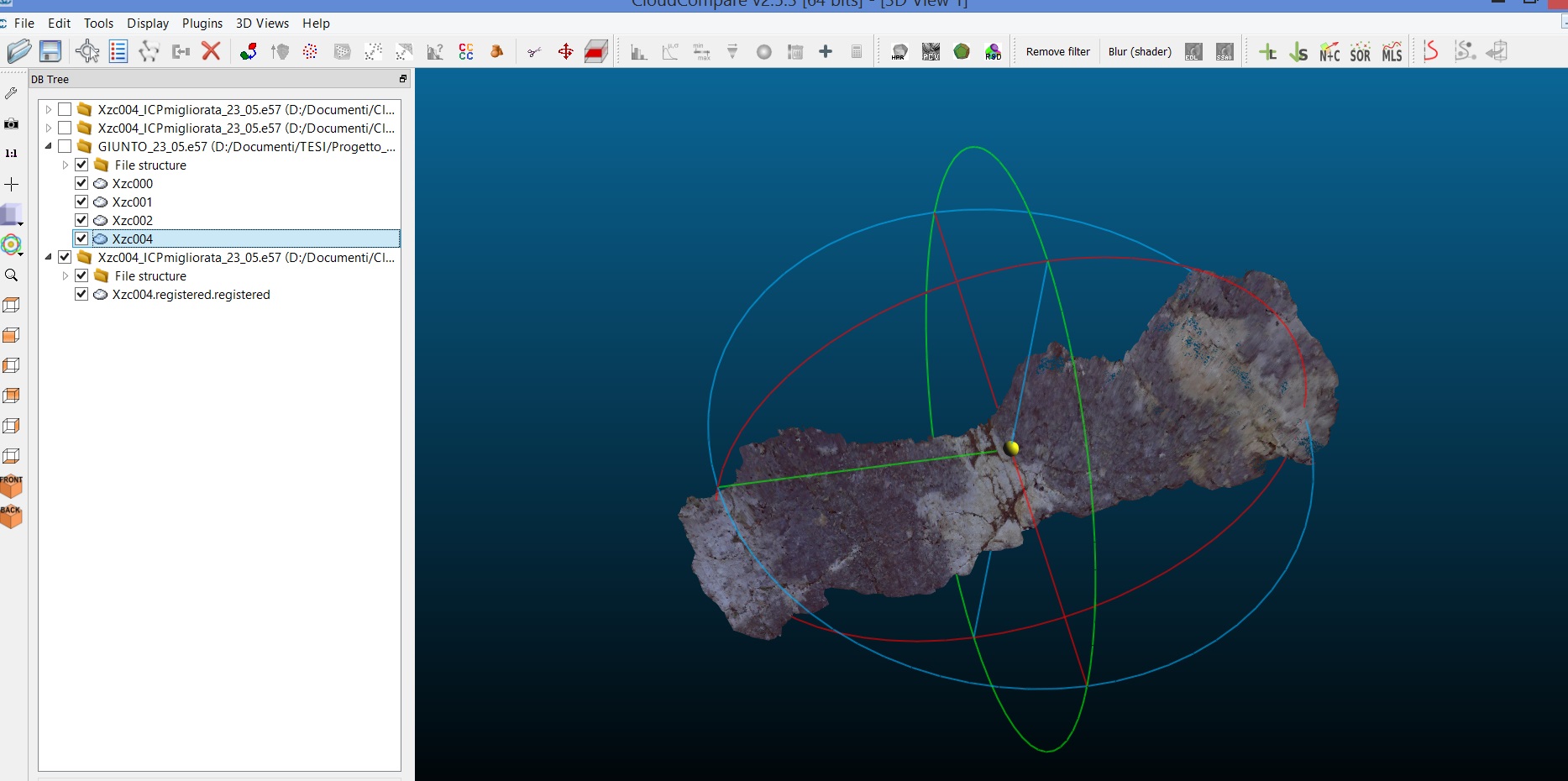

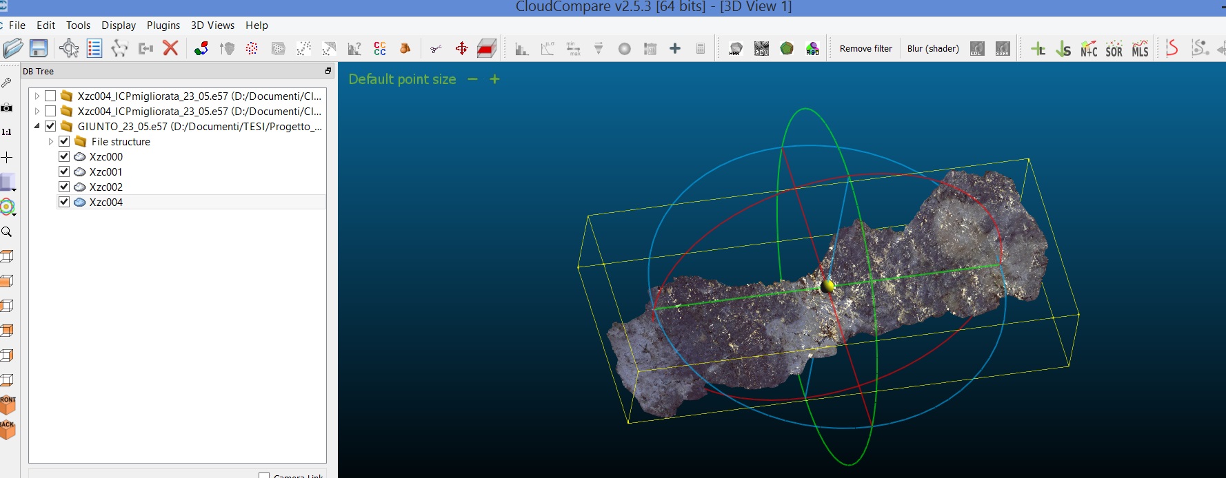

Hi, i imported 4 clouds already registered with another Software, and imported as one cloud but CC see them as 4 clouds yet. Now i need to get only one cloud. So i registered the fourth with the third, and the second with the first. Then i registered the two final clouds together and i got a final cloud. i want to know:
-is this method the best one to get the best results with 4 clouds?
-Can i state that CC is more powerfull software than the other to register point clouds?
ICP best registration with 4 points clouds.

Re: ICP best registration with 4 points clouds.
importing the first file in e.57 i didn't miss the registration, as you can see in the second photo the cloud is well registered but when you click on it to select it CC selects only one cloud. if you click in a determined part CC selects a cloud (for example XYZ004) if you click in a different position CC selects another cloud ( for examle the XYZ002 one). But i need to work with ONLY ONE cloud because i have to look for the only fit plane. So i thought that it might be better to do the ICP with CC. I did it and the results seems good.i did it with 1.000e(-9) with 1 000 000 points, and with enable farthest points removal. Now CC recognize ONLY ONE cloud that it is what i need.
Oh then you just have to select all clouds (CTRL key pressed) and then call 'Edit > Merge'.
And indeed, if the scans are already well registered, the ICP registration should perform well.
i have alredy done this before but i thought that through the ICP registration i would obtain better results. In fact with the command "merge" the noise points don't disappear, and with the ICP, ticking the comand "enable points removal" yes.
Oh ok. So it must have indeed refined the registration (as no points are removed). So keep this workflow ;)
